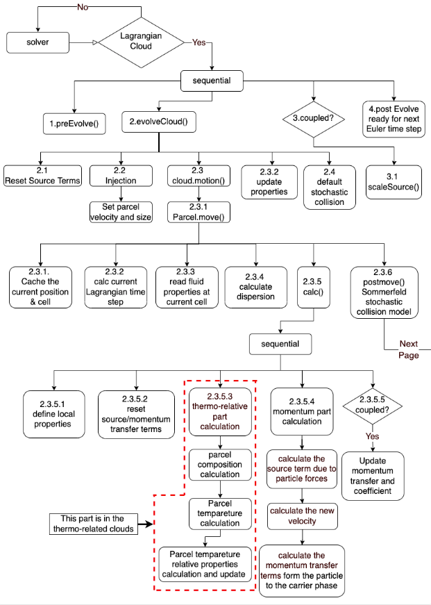

    默认的Lagrangian solver
    particleFoam, rhoParticleFoam 这两个是不解流场的,所以在使用这个solver的时候,需要有一个frozen的流场或者如果单纯解拉格朗日的话,就不用考虑流场的东西了
    所以只有one-way coupling对应之前版本icoUncoupledKinematicParcelFoam和uncoupledKinematicParcelFoam
    其他几个solver是解流场的,除了sprayFoam是用过的,其他的就不献丑了

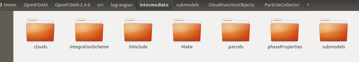

    @星星星星晴 您好,我参考了GOFUN2017_ParticleSimulations_slides.pdf ,建立一个文件夹,并把文件拷过来。
    mkdir lagrangian
    cp -r $FOAM_SRC/lagrangian/intermediate/ lagrangian/
    采用输出文件方法2,修改particleCollector,然后编译也成功了,
    但是输出文件中没有看到output.txt文件,
    Screenshot from 2022-08-22 17-30-43.png Screenshot from 2022-08-22 17-28-46.png
    我还需要在算例中设置什么命令才能调用particleCollector?
    谢谢

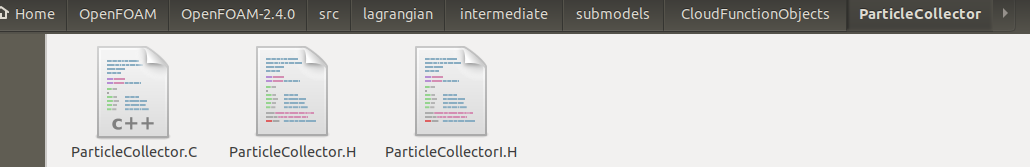

    @星星星星晴 您好,我这次直接在OpenFOAM-2.4.0下面的ParticleCollector.C文件修改,wclean, wmake libso,编译成功,避免了冲突问题。

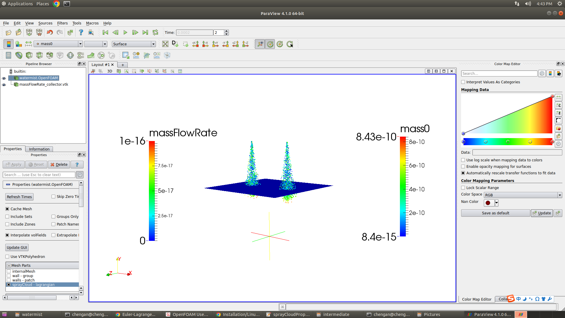

    之后,我在sprayCloudProperties文件中定义(用的是ParticleCollector.H自带例子)
    cloudFunctions
        particleCollector2
            type            particleCollector;
            mode            polygon;
            polygons
                    (-0.01 0.05 -0.01)
                    (-0.01 0.05 0.01)
                    (0.01 0.05 0.01)
                    (0.01 0.05 -0.01)
            normal          (0 0 1);
            negateParcelsOppositeNormal no;
            removeCollected no;
            surfaceFormat   vtk;
            resetOnWrite    no;
            log             yes;

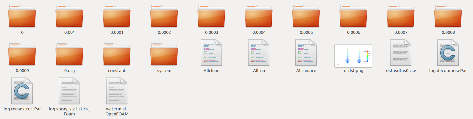

    运行至第一个时间步长就报错了
    [2] --> FOAM FATAL IO ERROR: [13]
    [13]
    [13] --> FOAM FATAL IO ERROR:
    [13] wrong token type - expected Scalar, found on line 0 the punctuation token '-'
    [13]
    [13] file: /home/chengan/OpenFOAM/chengan-2.4.0/run/sprayFoam/watermist/processor13/0/uniform/lagrangian/sprayCloud/sprayCloudOutputProperties.cloudFunctionObject.particleCollector2.massFlowRate at line 0.
    [13]
    [13]     From function operator>>(Istream&, Scalar&)
    [13]     in file lnInclude/Scalar.C at line 93.
    [13]
    FOAM parallel run exiting
    [13]
    [2] wrong token type - expected Scalar, found on line 0 the punctuation token '-'
    [2]
    [2] file: /home/chengan/OpenFOAM/chengan-2.4.0/run/sprayFoam/watermist/processor2/0/uniform/lagrangian/sprayCloud/sprayCloudOutputProperties.cloudFunctionObject.particleCollector2.massFlowRate at line 0.
    [2]
    [2]     From function operator>>(Istream&, Scalar&)
    [2]     in file lnInclude/Scalar.C at line 93.
    [2]
    [2]
    particleCollector output:
    MPI_ABORT was invoked on rank 2 in communicator MPI_COMM_WORLD
    with errorcode 1.
    NOTE: invoking MPI_ABORT causes Open MPI to kill all MPI processes.
    You may or may not see output from other processes, depending on
    exactly when Open MPI kills them.
    [chengan-MS-7C80:26316] 1 more process has sent help message help-mpi-api.txt / mpi-abort
    [chengan-MS-7C80:26316] Set MCA parameter "orte_base_help_aggregate" to 0 to see all help / error messages
    如果不用particleCollector,直接使用cloudFunctions{}算例可以运行。
    我没有搞明白到底什么地方出了问题

    在 中回复了 chengan.wang 最后由 编辑
    #17
    这部分你可以删掉,particlecollector总是有些问题,我也遇到过,后来不必要的东西全删掉了
        forAll(hitFaceIDs_, i)
            label faceI = hitFaceIDs_[i];
            scalar m = p.nParticle()*p.mass();
            if (negateParcelsOppositeNormal_)
                vector Uhat = p.U();
                Uhat /= mag(Uhat) + ROOTVSMALL;
                if ((Uhat & normal_[faceI]) < 0)
                    m *= -1.0;
            // add mass contribution
            mass_[faceI] += m;
            if (nSector_ == 1)
                mass_[faceI + 1] += m;
                mass_[faceI + 2] += m;
                mass_[faceI + 3] += m;
            if (removeCollected_)
                keepParticle = false;
    回来了,都回来了~

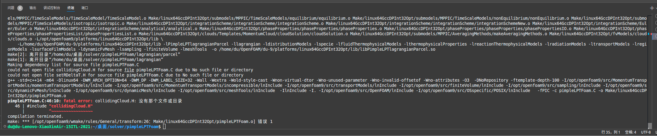

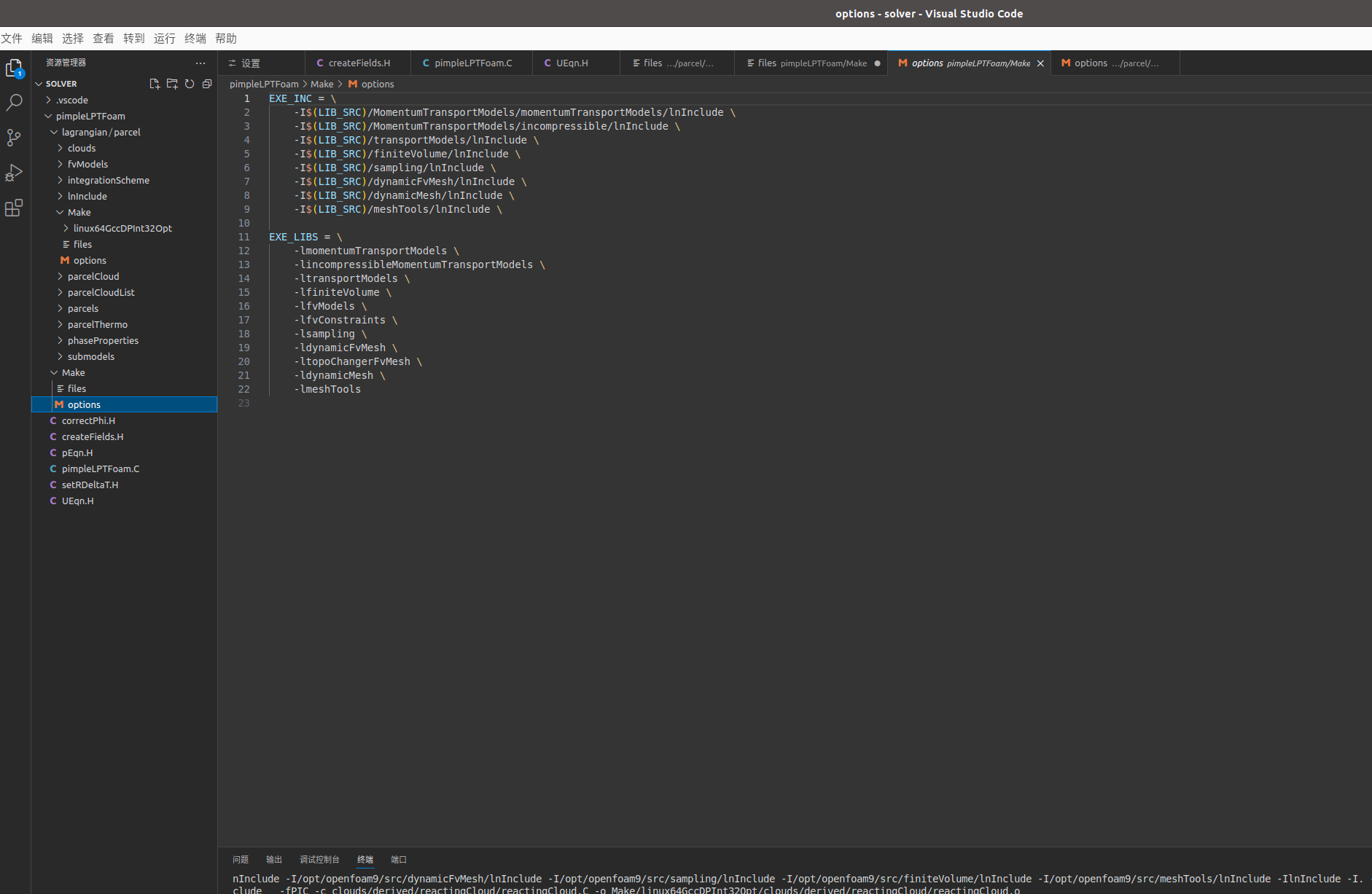

    @星星星星晴 前辈您好,我也是参考了这个教程(GOFUN2018)在pimpleFoam的基础上添加了求解粒子的部分,想请教您一下,这个教程里的方法是不是 流体对粒子,粒子对流体,粒子之间,粒子与壁面的相互作用都可以考虑,只需要在kinematicCloudProperties调整相关的设置就可以了?
    LBE
    星 2 条回复 最后回复
  • 星 离线
    星 离线
    星星星星晴 大神
    在 中回复了 vbcwl 最后由 编辑
    #19
    @vbcwl 这个也要看你用的是什么of版本,我记得好像在4之前 turbulence dispersion model是有问题的,kinematic parcel好像不做这步,忘了 不确定,需要你自己查一下,粒子之间好像kinematic parcel也没有吧,需要你确认,因为有的时候是有这个模型,但是他只是一个空函数,壁面就是简单的 stick,rebound, escape。
    然后drag 还有lift的cd cl好像也是有问题的,具体你需要根据你的需求来看,都得查code
    回来了,都回来了~
    vbcwlV 1 条回复 最后回复
  • vbcwlV 离线
    vbcwlV 离线
    vbcwl
    在 中回复了 星星星星晴 最后由 编辑
    #20
    @星星星星晴 感谢前辈:146:
    LBE
