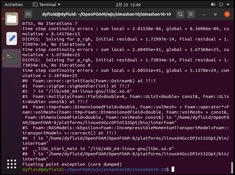

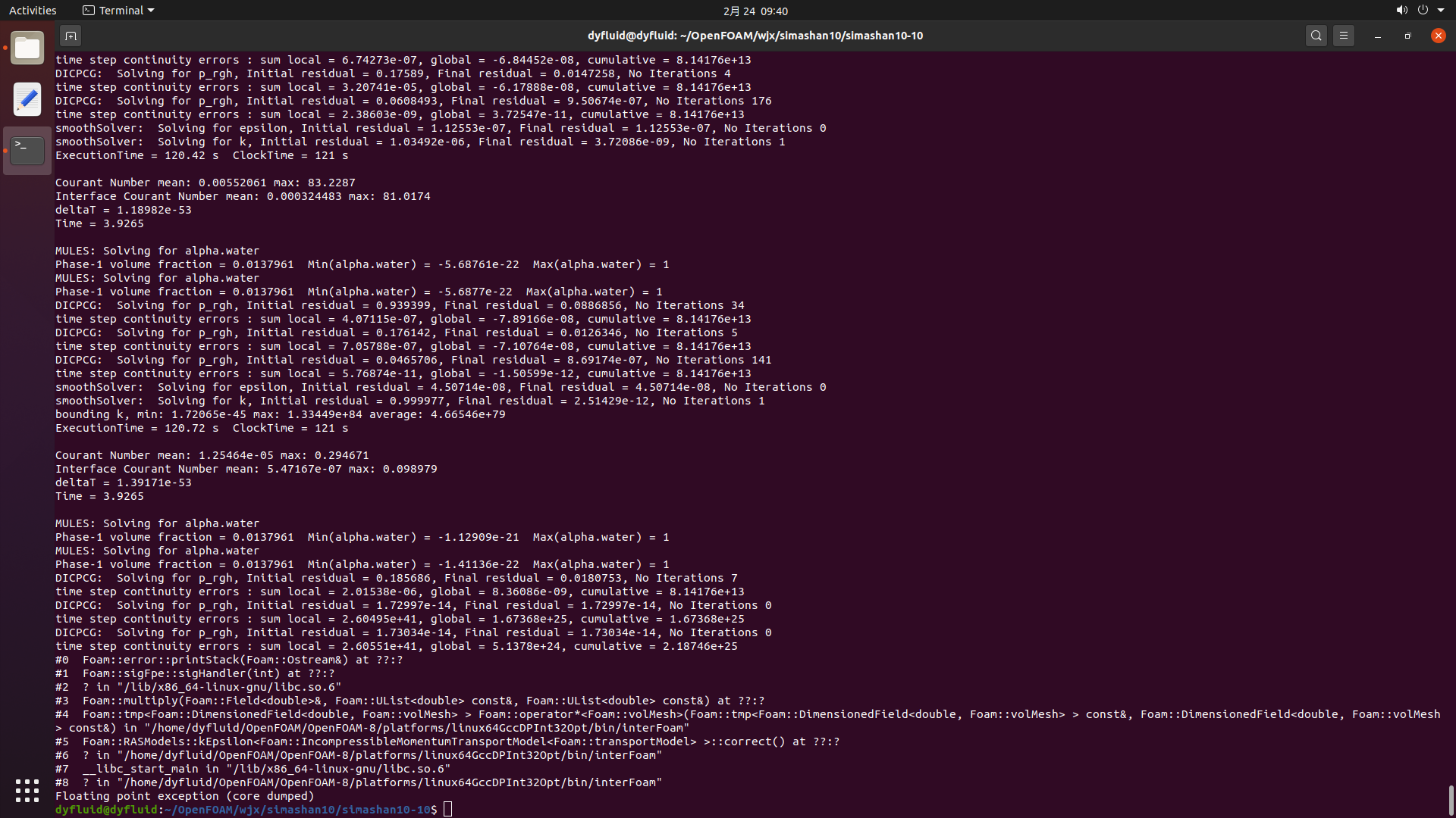

    @李东岳 这是最后发散的
    Courant Number mean: 0.00552061 max: 83.2287
    Interface Courant Number mean: 0.000324483 max: 81.0174
    deltaT = 1.18982e-53
    Time = 3.9265
    MULES: Solving for alpha.water
    Phase-1 volume fraction = 0.0137961  Min(alpha.water) = -5.68761e-22  Max(alpha.water) = 1
    Phase-1 volume fraction = 0.0137961  Min(alpha.water) = -5.6877e-22  Max(alpha.water) = 1
    DICPCG:  Solving for p_rgh, Initial residual = 0.939399, Final residual = 0.0886856, No Iterations 34
    time step continuity errors : sum local = 4.07115e-07, global = -7.89166e-08, cumulative = 8.14176e+13
    DICPCG:  Solving for p_rgh, Initial residual = 0.176142, Final residual = 0.0126346, No Iterations 5
    time step continuity errors : sum local = 7.05788e-07, global = -7.10764e-08, cumulative = 8.14176e+13
    DICPCG:  Solving for p_rgh, Initial residual = 0.0465706, Final residual = 8.69174e-07, No Iterations 141
    time step continuity errors : sum local = 5.76874e-11, global = -1.50599e-12, cumulative = 8.14176e+13
    smoothSolver:  Solving for epsilon, Initial residual = 4.50714e-08, Final residual = 4.50714e-08, No Iterations 0
    smoothSolver:  Solving for k, Initial residual = 0.999977, Final residual = 2.51429e-12, No Iterations 1
    bounding k, min: 1.72065e-45 max: 1.33449e+84 average: 4.66546e+79
    ExecutionTime = 108.46 s  ClockTime = 109 s
    Courant Number mean: 1.25464e-05 max: 0.294671
    Interface Courant Number mean: 5.47167e-07 max: 0.098979
    deltaT = 1.39171e-53
    Time = 3.9265
    Phase-1 volume fraction = 0.0137961  Min(alpha.water) = -1.12909e-21  Max(alpha.water) = 1
    Phase-1 volume fraction = 0.0137961  Min(alpha.water) = -1.41136e-22  Max(alpha.water) = 1
    DICPCG:  Solving for p_rgh, Initial residual = 0.185686, Final residual = 0.0180753, No Iterations 7
    time step continuity errors : sum local = 2.01538e-06, global = 8.36086e-09, cumulative = 8.14176e+13
    DICPCG:  Solving for p_rgh, Initial residual = 1.72997e-14, Final residual = 1.72997e-14, No Iterations 0
    time step continuity errors : sum local = 2.60495e+41, global = 1.67368e+25, cumulative = 1.67368e+25
    DICPCG:  Solving for p_rgh, Initial residual = 1.73034e-14, Final residual = 1.73034e-14, No Iterations 0
    time step continuity errors : sum local = 2.60551e+41, global = 5.1378e+24, cumulative = 2.18746e+25
    S 1 条回复 最后回复

    目前只能看出发散了。库朗数太大。直接发散了。你可以换结构网格试一下。应该会好很多。

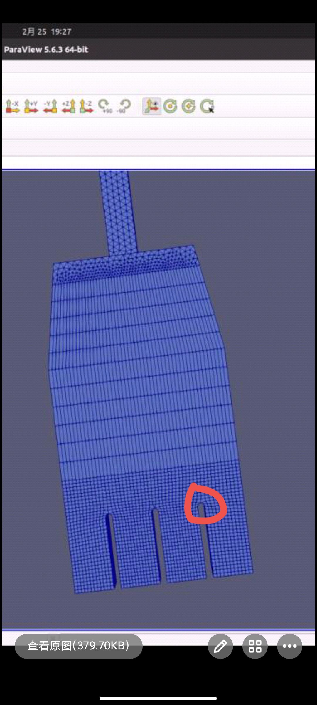

    背面有圆弧,很难全部用结构网格
    你目前画的圆弧的地方就是结构网格啊 :135:
    目前只能看出发散了

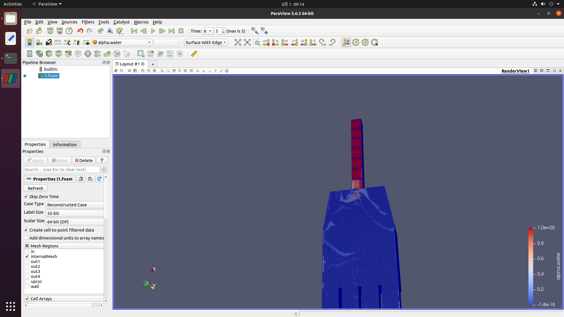

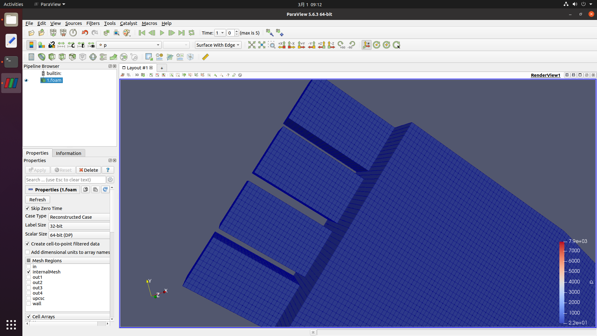

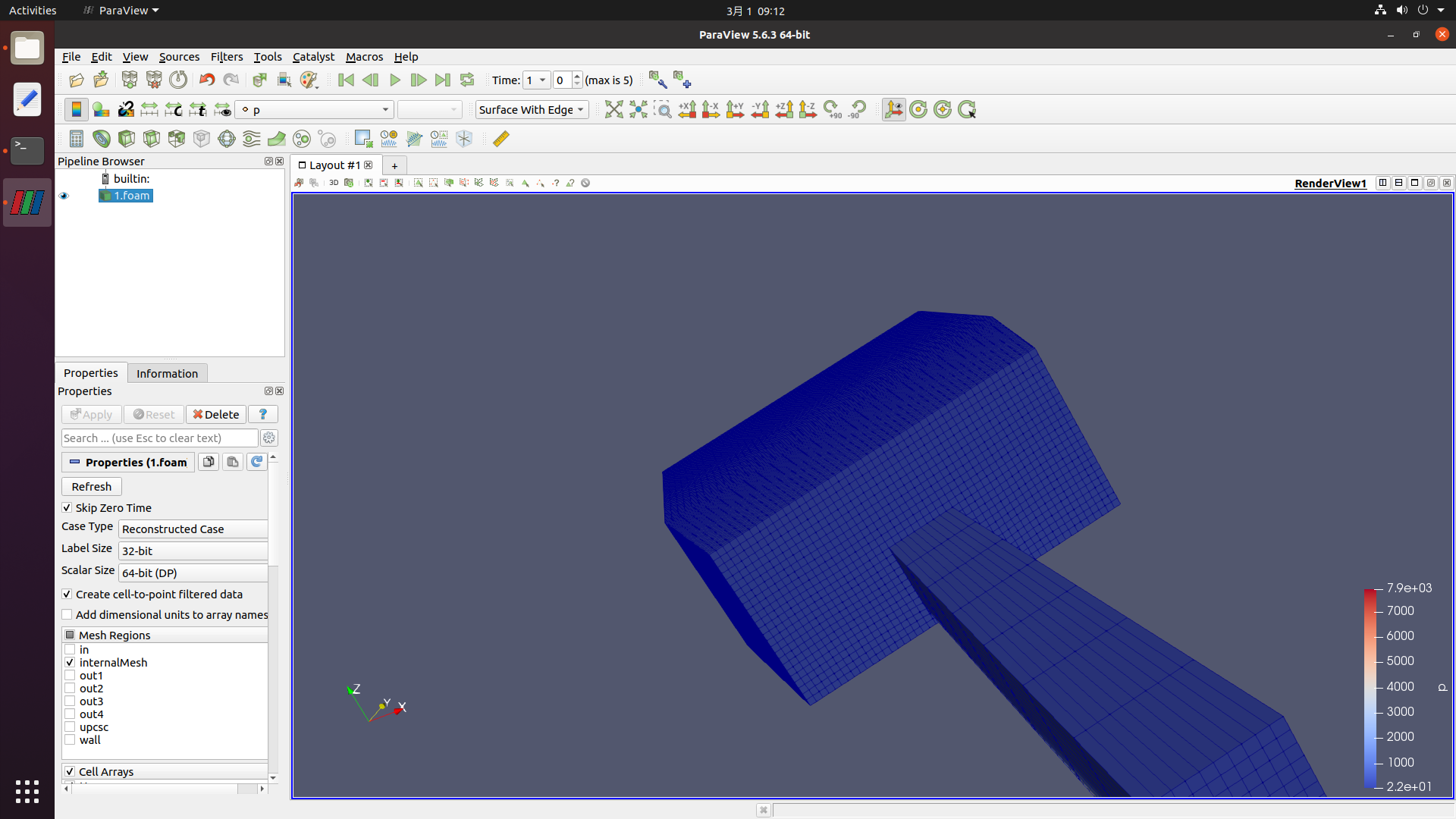

    @李东岳 把圆弧去掉,全部改成六面体网格,还是发散。
    从细管流入水池就发散了。
    附了log文件
