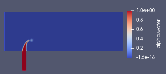

    使用compressibleInterFoam,给气相添加组分方程,如下:
        volScalarField Yt(0.0*Y[0]);
        alpharho2 =  alpha2*rho2;
        volScalarField alphamuEff("alphamuEff",alpha2*turbulence.muEff());
        forAll(Y, i)
            if (i != inertIndex && i != liquidIndex && composition.active(i))
                volScalarField& Yi = Y[i];
                fvScalarMatrix YEqn
                    fvm::ddt(alpharho2, Yi)
                  + fvm::div(alpharho2Phi, Yi)
                  - fvm::laplacian(alphamuEff, Yi)
                  fvOptions(rho, Yi)
                YEqn.relax();
                fvOptions.constrain(YEqn);
                YEqn.solve("Yi");
                fvOptions.correct(Yi);
                Yi.max(0.0);
                Yt += Yi;
        Y[inertIndex] = scalar(1) - Yt;
        Y[inertIndex].max(0.0);

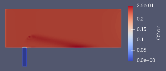

    对一个简单的横向射流的算例进行计算,横向流入均匀速度空气(组分只有N2和O2),垂直向上射入水,下图分别为相体积分数和O2的质量分数,在相体积分数为1的部分,为什么还会有气体组分呢。
    李东岳李 L R 3 条回复 最后回复
    在 中回复了 Tens 最后由 编辑
    @tens 按照你这样植入是避免不了的,需要特殊的算法,推荐你看这个文章 https://www.jianguoyun.com/p/DZ3nYjMQwr6YCBiuyYAE

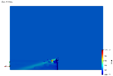

    @Tens 您好,我参考了phaseScalarTransport.C的方法,人为地乘以了alpha来区分界面,您看这样合理嘛?但是在求解过程中,当来流温度过高时,会出现局部质量分数过大的问题,非常困惑
    phaseScalarTransport.C:
    if (phi.dimensions() == dimMass/dimTime)
            const volScalarField& rho =
                mesh_.lookupObject<volScalarField>(rhoName_);
            while (control.correctNonOrthogonal())
                fvScalarMatrix PhiEqn
                    fvm::laplacian(Phi, laplacianScheme)
                  + fvc::ddt(rho, alpha)
                  + fvc::div(alphaPhi)
                PhiEqn.solve(pName_);
                if (control.finalNonOrthogonalIter())
                    alphaPhi += PhiEqn.flux();
    if (alphaPhi.dimensions() == dimMass/dimTime)
            for (int i=0; i<=nCorr_; i++)
                fvScalarMatrix fieldEqn
                    fvm::ddt(alpha, rho, s_)
                  + fvm::div(alphaPhi, s_, divScheme)
                  - fvm::laplacian
                        fvc::interpolate(alpha)*fvc::interpolate(D),
                        s_,
                        laplacianScheme
                    fvOptions_(alpha, rho, s_)
                  - fvm::ddt(residualAlpha_*rho, s_)
                  + fvc::ddt(residualAlpha_*rho, s_)
                fieldEqn.relax(relaxCoeff);
                fvOptions_.constrain(fieldEqn);
                fieldEqn.solve(schemesField_);
     if (!alphaSPtr_.valid())
                alphaSPtr_.set
                    new volScalarField
                        IOobject
                            "alpha"
                          + word(toupper(fieldName_[0]))
                          + fieldName_(1, fieldName_.size() - 1),
                            mesh_.time().timeName(),
                            mesh_,
                            IOobject::NO_READ,
                            IOobject::AUTO_WRITE
                        mesh_,
                        dimensionedScalar(s_.dimensions(), Zero)
            alphaSPtr_() = alpha*s_;//人为地乘以alpha
    https://link.springer.com/article/10.1007/s11440-023-01982-6 可以看下这个文章
    这个也不是特别的稳定。
