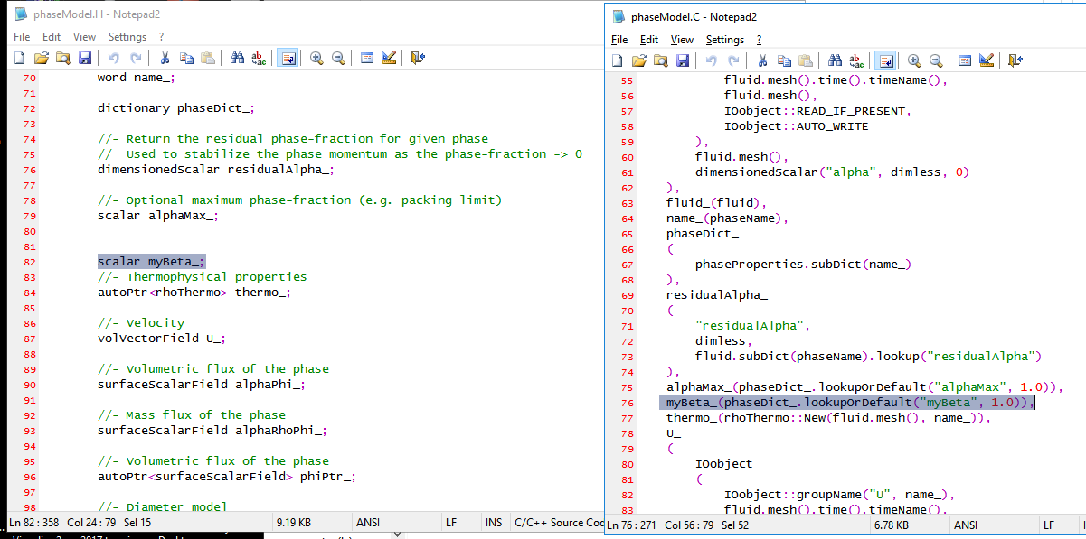

    I added a new scalar in twophasesystem/phaseModel.C and I compiled successfully. The problem is that there is an error when I run the case. My objective is to use this constant in phasePair.C to calculate Re(). In oder to change the constant myBeta directly from dictionary (phaseProperties) without compiling every time, I think it is necessary to add a new scalar like alphaMax in phaseModel.C. Do you have any tip?

    I guess you use myBeta_ just like alphaMax: myBeta(), or just by its name?
    the position where you put the declaration of myBeta_ shows that myBeta_ is a private variable.
    myBeta_(phaseDict_.lookuporDefault("myBeta", 1.0)), is OK, because it's just initialization.
    you should define a member function to return a private variable just like alphaMax().
    the errors seems like lost address of something. Maybe the private variable's address without authority.
    K 1 条回复 最后回复
  • K 离线
    K 离线
    kimy
    @bestucan Thanks. I defined "myBeta" according to the definition of alphaMax in all positions where it occurs.
    Also
            scalar alphaMax() const
                return alphaMax_;
            scalar myBeta() const
                return myBeta_;
    bestucanB 1 条回复 最后回复

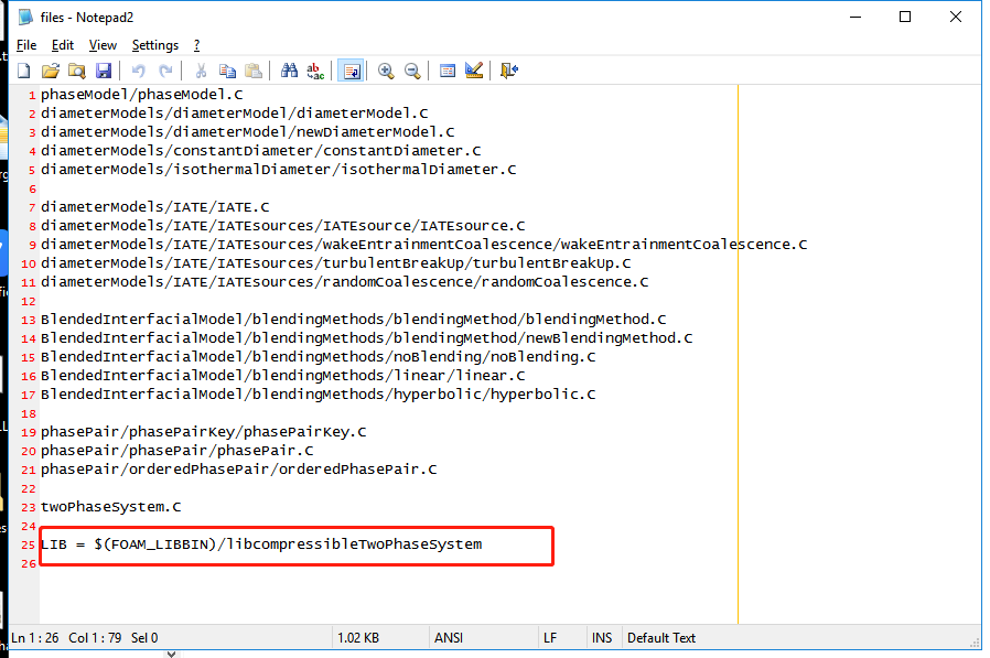

    @kimy try this way: just define myBeta_ and do not use it.
    see is there any error. if not, the errors are caused by function myBeta().
    otherwise, keep on delete the part of code you added until the errors disapear.
    you'll find the "error" code.
    if the error occurs after you delete all the modification. you should check the makefile.
    principle: make sure origin code works well. then, add your code slowly. (add one or two lines and run it )
    so it's easy find which part of code is wrong.

    my way(without mention the modification shown in diff file ):
    1. copy entire multiphaseEulerFoam into $FOAM_RUN/applications/solvers (bu not ./Allwamke)
    can@x260-TC ~/Documents/code/C/openfoam/can-8/applications/solvers %tree -L 2                                                                                                                      (git)-[master]-
    └── multiphaseEulerFoam
        ├── Allwclean
        ├── Allwmake
        ├── functionObjects
        ├── include
        ├── interfacialCompositionModels
        ├── interfacialModels
        ├── multiphaseCompressibleMomentumTransportModels
        ├── multiphaseEulerFoam
        ├── multiphaseThermophysicalTransportModels
        └── phaseSystems
    9 directories, 2 files
    1. find and replace all $(FOAM_LIBBIN) with $(FOAM_USER_LIBBIN)
    find ./ -type f -exec sed -i 's/\$(FOAM_LIBBIN)/\$(FOAM_USER_LIBBIN)/' {} \;
    1. enter phaseSystems run wmake to build libmyphaseSystem.so
    2. enter multiphaseEulerFoam run wmake(not ./Allwamke) to build solver mymultiphaseEulerFoam
    3. run the case

    @bestucan Many Thanks. I have a confusion that you defined the following two scalar and function in phaseModel.H
    <         scalar myBeta_;
    195,196d193
    <         scalar myBeta() const;
    While in original file, according to the definition of alphaMax
                return myBeta_;
    and you put this code in phaseModel.C ?
    /home/can/.local/share/OpenFOAM/OpenFOAM-8/applications/solvers/multiphase/multiphaseEulerFoam/phaseSystems/phaseModel/phaseModel/phaseModel.C
    88,89c88
    <     alphaMax_(fluid.subDict(phaseName).lookupOrDefault("alphaMax", 1.0)),
    <     myBeta_(fluid.subDict(phaseName).lookupOrDefault("myBeta", 1.0))
    143,147d141
    < Foam::scalar Foam::phaseModel::myBeta() const
    <     retu
    在 中回复了 kimy 最后由 编辑

    kimy
    在 中回复了 bestucan 最后由 kimy 编辑
    @bestucan But why alphaMax() was originally defined in the phaseModel.H without any error?
                return alphaMax_;
    After I defined only scalar myBeta() in phaseModel.H, the following error occurs:
    In file included from phaseModel/phaseModel.C:26:0:
    phaseModel/phaseModel.H:158:29: error: invalid declarator before 'd'
             tmp<volScalarField> d() const;
    phaseModel/phaseModel.H:162:26: error: non-member function 'const Foam::PhaseCompressibleTurbulenceModel<Foam::phaseModel>& Foam::turbulence()' cannot have cv-qualifier
                 turbulence() const;
    在 中回复了 kimy 最后由 编辑
