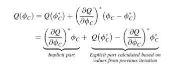

    似乎是在susp.field为正的时候,对变量k的方程将源项化为SpVpk,把SpVp加到fvm.diag()里面去了,当susp.field为负的时候,对变量k的方程将源项化为SuVp,将SuVp加到fvm.source()里面去了。我不太清楚Openfoam是怎么实现下面这样的源项的线化的。
    将源项在上一次课的值处Taylor展开,implicit part 加到fvm.diag()里面,explicit part加到fvm.source()里面去?

    @yfclark 源项的线化主要涉及稳定性和收敛速率,加强系数矩阵的对角占优,具体可参考Patankar教授经典教材《Numerical Heat Transfer and Fluid Flow》的4.2-5节(48-49页)。

    Jasak PhD thesis, P112:
    In order to improve the solver convergence, it is desirable to increase the diagonal
    dominance of the system. Discretisation of the linear part of the source term, Eqn.
    (3.36), is closely related to this issue. If Sp < 0, its contribution increases diagonal
    dominance and Sp is included into the diagonal. In the case of Sp > 0, diagonal
    dominance would be decreased. It is more effective to include this term into the
    source and update it when the new solution is available. This measure is, however,
    not sufficient to guarantee the diagonal dominance of the matrix.
