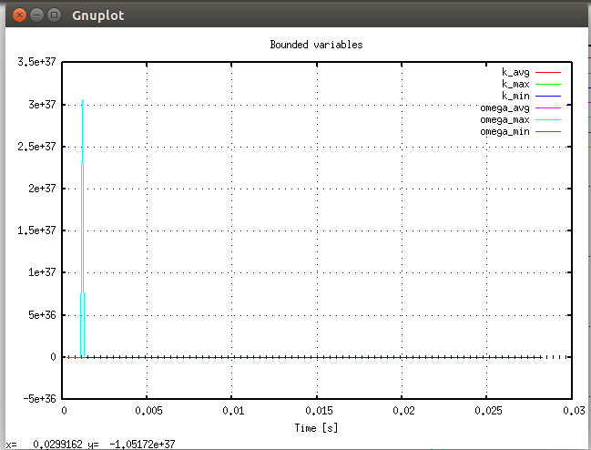

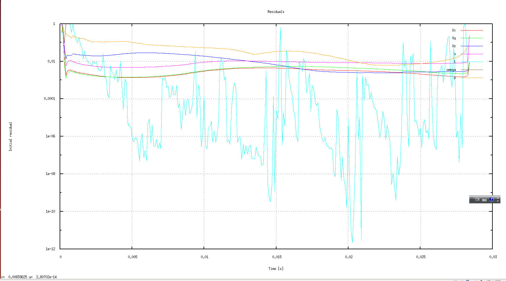

    omega飙升
    0_1494809875821_upload-4d2ab3d3-7660-4854-96eb-7690a9048342

    bounding omega, min: -4.71803e+50 max: 1.27516e+67 average: 1.57147e+61
    smoothSolver:  Solving for k, Initial residual = 0.993077, Final residual = 6.53872e-31, No Iterations 1
    bounding k, min: -1.47294e-10 max: 799.109 average: 2.43261
    ExecutionTime = 3149.37 s  ClockTime = 3162 s

    smoothSolver:  Solving for Ux, Initial residual = 0.00160754, Final residual = 0.000122563, No Iterations 5
    smoothSolver:  Solving for Uy, Initial residual = 0.00234167, Final residual = 0.000174383, No Iterations 5
    smoothSolver:  Solving for Uz, Initial residual = 0.00305302, Final residual = 0.000264702, No Iterations 5
    smoothSolver:  Solving for e, Initial residual = 0.00890675, Final residual = 0.000544697, No Iterations 3
    GAMG:  Solving for p, Initial residual = 0.0456857, Final residual = 0.00450887, No Iterations 11
    GAMG:  Solving for p, Initial residual = 0.00532448, Final residual = 0.000530223, No Iterations 148
    time step continuity errors : sum local = 0.318517, global = 0.00804085, cumulative = 1.42133
    rho max/min : 1.34304 0.944974
    smoothSolver:  Solving for omega, Initial residual = 1, Final residual = 5.03085e-61, No Iterations 1
    bounding omega, min: -6.12926e+56 max: 1.89257e+63 average: 2.58001e+57
    smoothSolver:  Solving for k, Initial residual = 0.0986294, Final residual = 2.34926e-17, No Iterations 1
    bounding k, min: -3.64697e-08 max: 1561.98 average: 2.37097

    smoothSolver:  Solving for omega, Initial residual = 1, Final residual = 2.76757e-55, No Iterations 1
    bounding omega, min: -2.79393e+51 max: 1.89919e+65 average: 2.72917e+59
    smoothSolver:  Solving for k, Initial residual = 0.00338243, Final residual = 8.55618e-21, No Iterations 1
    bounding k, min: -2.59751e-09 max: 2425.35 average: 2.31181

    smoothSolver:  Solving for Ux, Initial residual = 0.00844988, Final residual = 0.000751562, No Iterations 3
    smoothSolver:  Solving for Uy, Initial residual = 0.00963742, Final residual = 0.000907189, No Iterations 3
    smoothSolver:  Solving for Uz, Initial residual = 0.00423285, Final residual = 0.000343988, No Iterations 5
    smoothSolver:  Solving for e, Initial residual = 0.24105, Final residual = 0.013761, No Iterations 2

    最近看你一直在算这个算例,好像卡在这了?你这个就是发散了,发散的原因非常多,不能简单用一种药治疗。
    把你的算例发给我试试?网格数量最好少于1万,或者5万以下。
