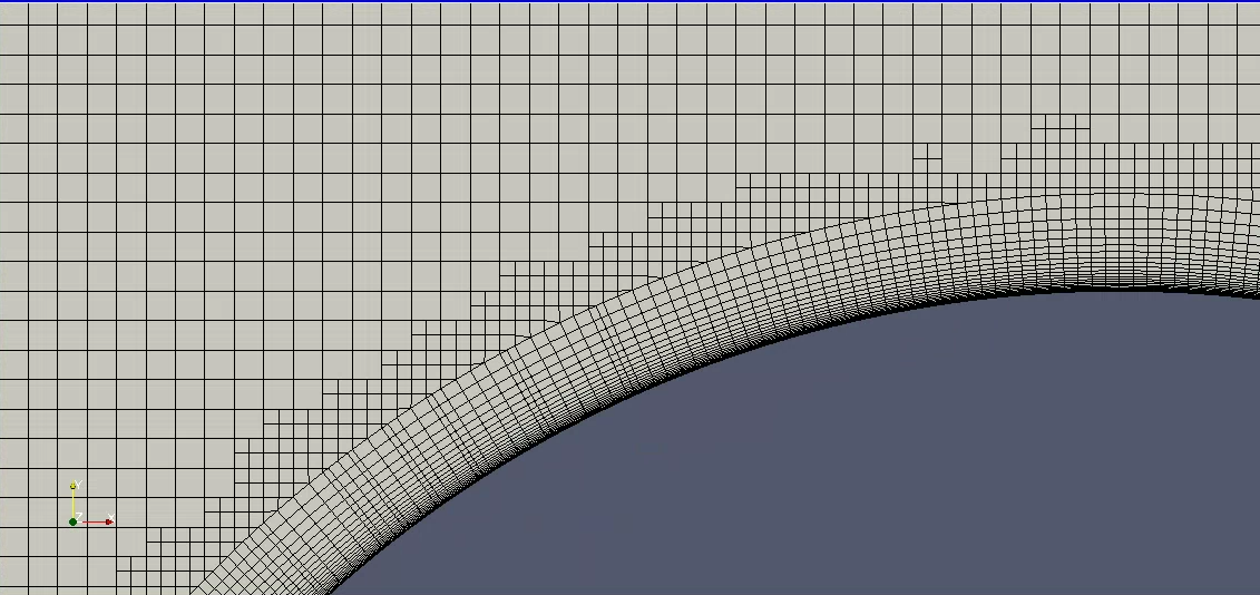

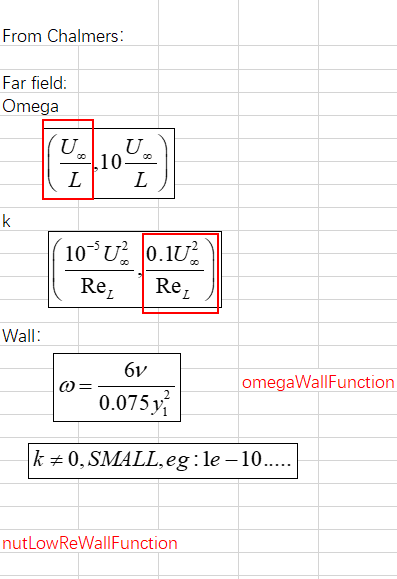

    @random_ran 老师您好!借楼向您请教一些问题。我目前进行二维圆柱绕流的计算,Re=1e4和5e4。圆柱直径D=0.1m,介质是水(nu=1e-6),计算域和生成网格(STARCCM生成并导入)如图所示:
    湍流模型为 RAS kOmegaSST,边界条件参考Chalmers大学教程设置:
    计算结果如下:最大库朗数为0.27,最大壁面y+<0.3,阻力系数误差<1%,St误差约为30%。St计算公式为:fD/U,f由升力时历曲线fft得到。
    fvSchemes:
    ddtSchemes
        default         Euler;
    gradSchemes
        default         cellLimited Gauss linear 0.5;
        //grad(p)         Gauss linear;
        grad(U)         cellLimited Gauss linear 1;
    divSchemes
        default         none;
        div(phi,U)      Gauss linearUpwindV grad(U);
        div(phi,k)      Gauss linearUpwind default;
        div(phi,omega)	Gauss linearUpwind default;
        div((nuEff*dev(T(grad(U))))) Gauss linear;
    laplacianSchemes
        default         Gauss linear limited 1;
    interpolationSchemes
        default         linear;
    snGradSchemes
        default         limited 1;
    fvSolution
    solvers
        p
            solver          PCG;
            preconditioner  DIC;
            tolerance       1e-08;
            relTol          0;
        pFinal
            solver          PCG;
            preconditioner  DIC;
            tolerance       1e-08;
            relTol          0;
        U
            solver          BiCGStab;
            preconditioner  DILU;
            tolerance       1e-07;
            relTol          0;
        k
            solver          BiCGStab;
            tolerance       1e-07;
            relTol          0;
        epsilon
            solver          BiCGStab;
            tolerance       1e-07;
            relTol          0;
        omega
            solver          BiCGStab;
            tolerance       1e-07;
            relTol          0;
    PISO
        nCorrectors     3;
        nNonOrthogonalCorrectors 3;
        pRefCell        0;
        pRefValue       0;
    跪求老师指点迷津,如何提高St计算精度。
