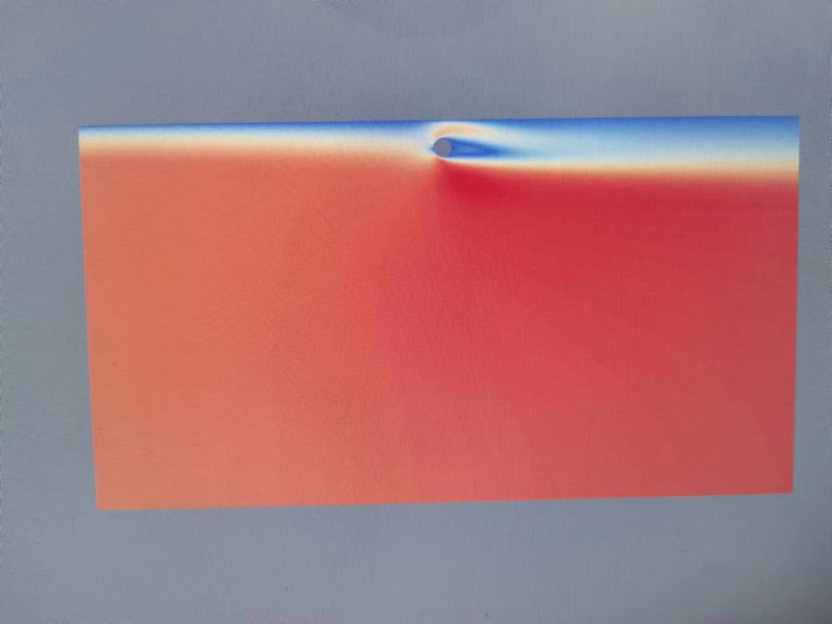

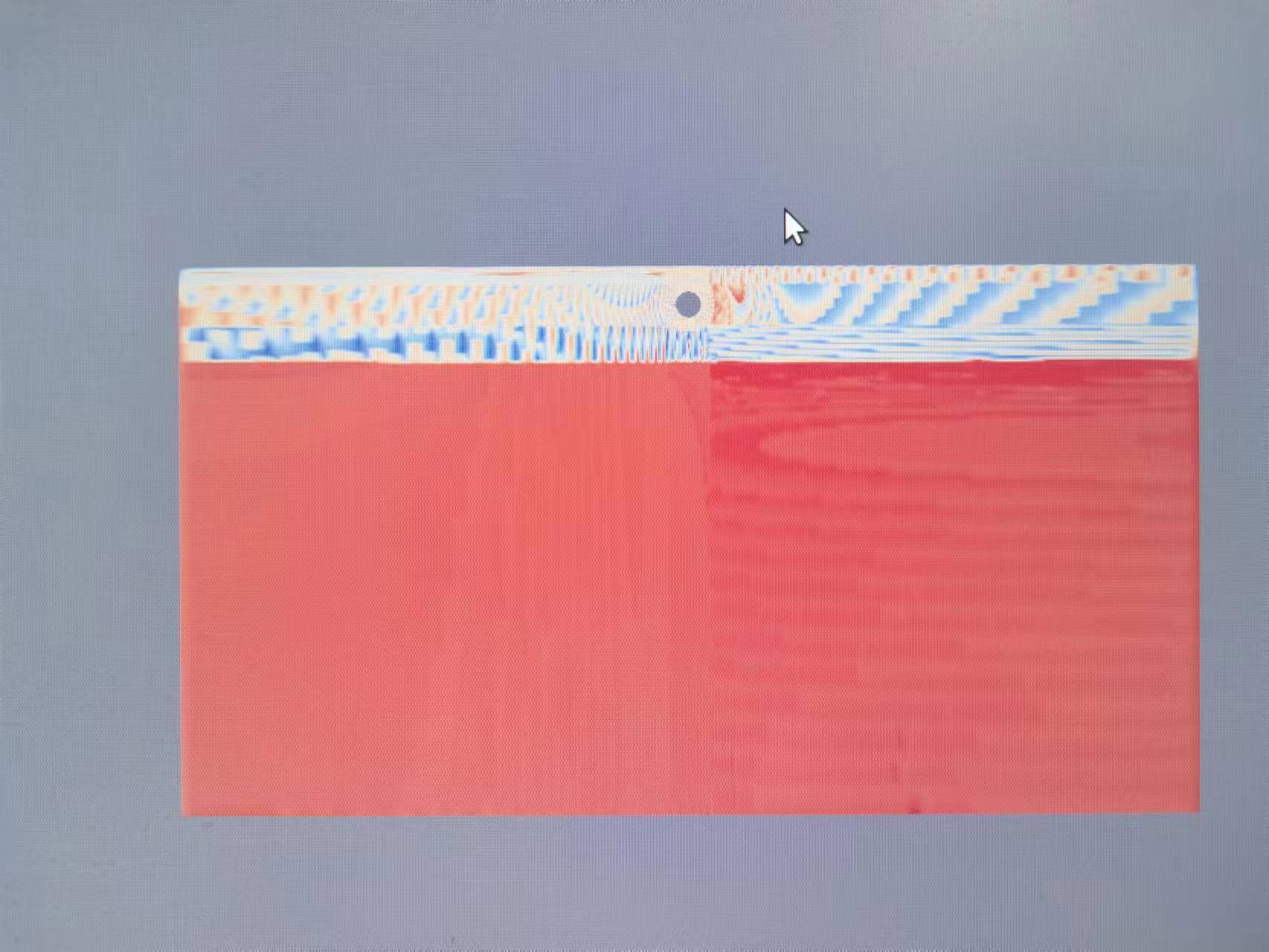

    @李东岳 李老师您好!首先感谢您的回复。我在fe-40的tutorial中找到pisoFoam的算例——cavity。执行decomposePar依旧存在上述问题。无论是用scotch还是simple均会存在上述问题。目前我是在dyfluid下载的虚拟机上运行的。
    | \\      /  F ield         | foam-extend: Open Source CFD                    |
    |  \\    /   O peration     | Version:     4.0                                |
    |   \\  /    A nd           | Web:         http://www.foam-extend.org         |
    |    \\/     M anipulation  | For copyright notice see file Copyright         |
    Build    : 4.0
    Exec     : decomposePar
    Date     : May 17 2024
    Time     : 14:35:59
    Host     : dyfluid
    PID      : 69780
    CtrlDict : "/home/dyfluid/fe40_tanhao/pisoFoam/cavity/system/controlDict"
    Case     : /home/dyfluid/fe40_tanhao/pisoFoam/cavity
    nProcs   : 1
    SigFpe   : Enabling floating point exception trapping (FOAM_SIGFPE).
    Create time
    Time = 0
    Create mesh for region region0
    Calculating distribution of cells
    --> FOAM Warning :
        From function dlLibraryTable::open(const fileName& functionLibName)
        in file db/dlLibraryTable/dlLibraryTable.C at line 124
        could not load libmpi.so.1: cannot open shared object file: No such file or directory
    --> FOAM Warning :
        From function decompositionMethod::loadExternalLibraries()
        in file decompositionMethod/decompositionMethod.C at line 508
        Loading of decomposition library libparMetisDecomp.so unsuccesful. Some decomposition methods may not be  available
    Selecting decompositionMethod scotch
    之前一直没有注意到这个Warning,反正都能算,但有时reconstructPar的结果会出现混乱。如图1所示。这张图片是paraview在case type 为 Reconstructed Case 时显示的。cgi-bin_mmwebwx-bin_webwxgetmsgimg_&MsgID=4854121309350350526&skey=@crypt_b72978c9_358c7d96cb1033dde636a9561be86dc6&mmweb_appid=wx_webfilehelper.jpg
    然而如果不进行reconstructPar,在paraview在case type 为 Decomposed Case 时则显示内容如图2所示。用单核跑的结果仍为图2所示。
    cgi-bin_mmwebwx-bin_webwxgetmsgimg_&MsgID=8067256724055081697&skey=@crypt_b72978c9_358c7d96cb1033dde636a9561be86dc6&mmweb_appid=wx_webfilehelper.jpg
    李老师请多指教!!!
