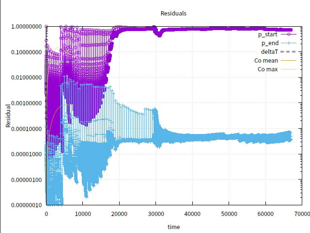

    症状:
    • 圆柱数量多的情况,每次PIMPLE迭代(nOuterCorrectors)的压力方程初始残差降不下来也不发散
    Courant Number mean: 2.398253992e-06 max: 0.0215123576
    deltaT = 0.04
    Time = 6.7
    PIMPLE: iteration 1
    DICPCG:  Solving for pcorr, Initial residual = 1, Final residual = 0.09682197649, No Iterations 82
    DICPCG:  Solving for pcorr, Initial residual = 0.09688756857, Final residual = 0.00927208952, No Iterations 82
    DICPCG:  Solving for pcorr, Initial residual = 0.01741032791, Final residual = 0.00171820424, No Iterations 86
    DICPCG:  Solving for pcorr, Initial residual = 0.002315321063, Final residual = 0.0002293036835, No Iterations 341
    DICPCG:  Solving for pcorr, Initial residual = 0.0005365215345, Final residual = 9.975987647e-10, No Iterations 791

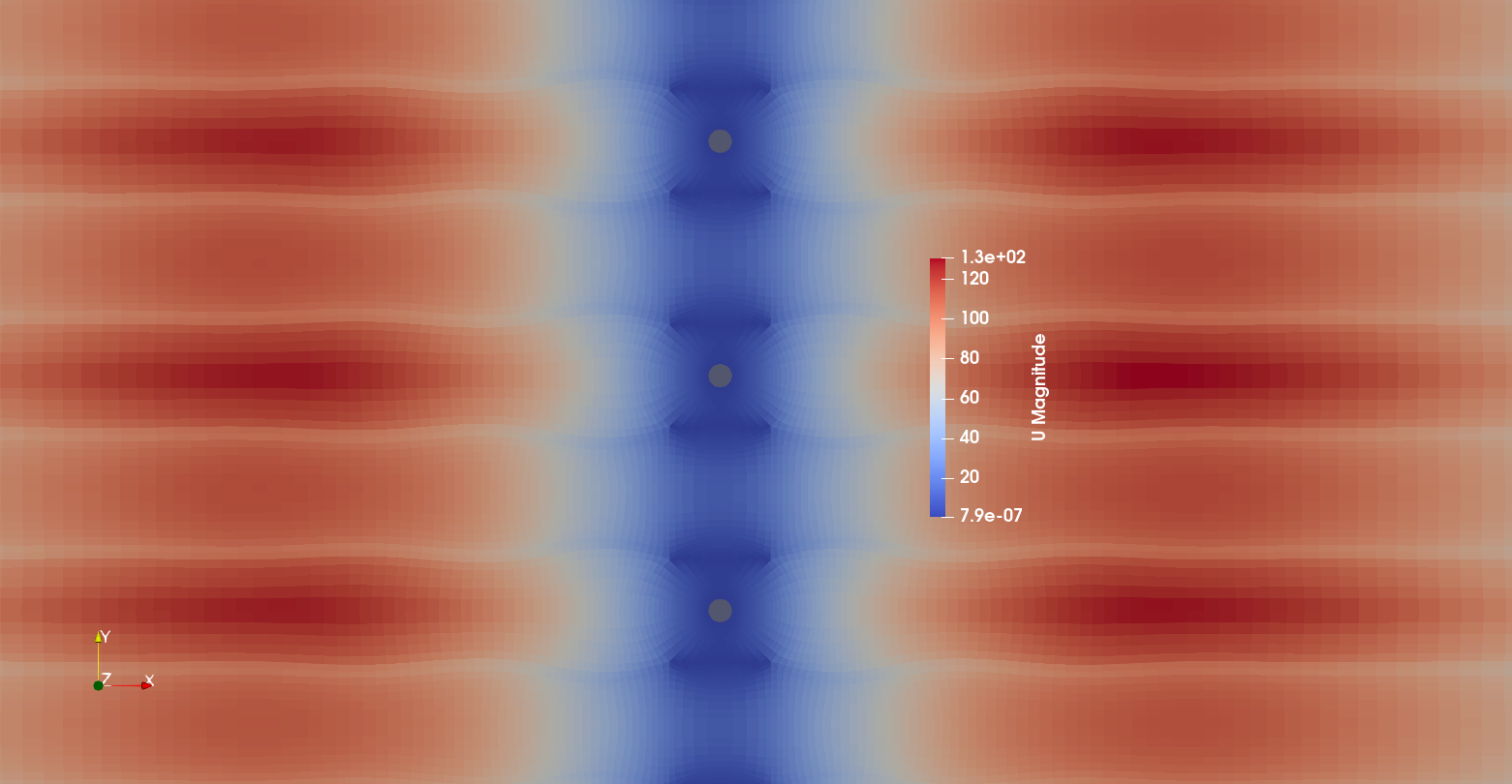

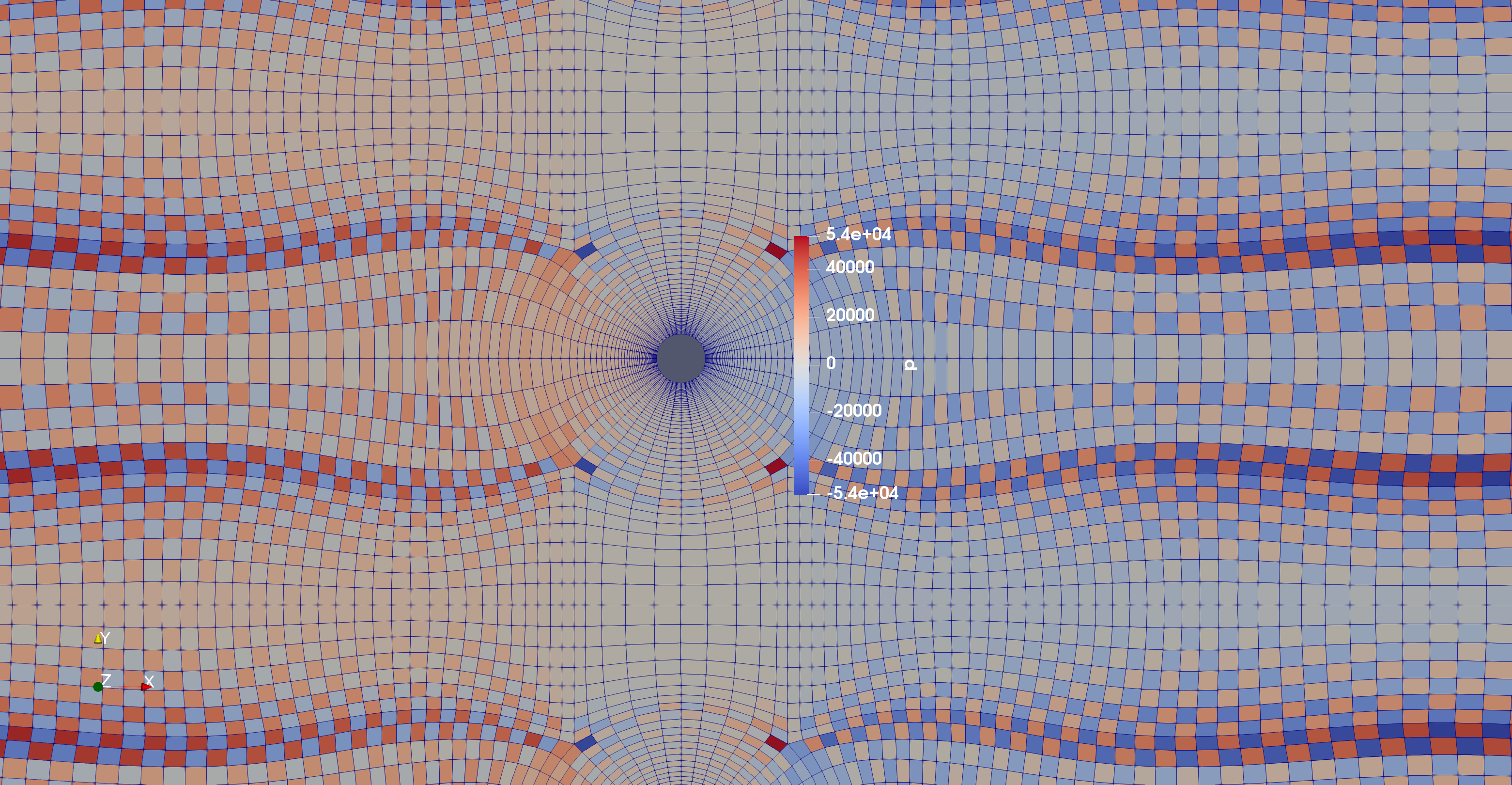

    • 流场明显发散了

    • 网格。从流场上看,跟网格关系很大。但按理说低雷诺数计算对网格并不敏感,而且网格质量不差(平均non-orthogonality只6.5),网格非正交修正也都收敛了。雷诺数高一点能算,少几个圆柱也能算。
    这里面有没有隐含着什么低雷诺数计算的理论缺陷呢?
