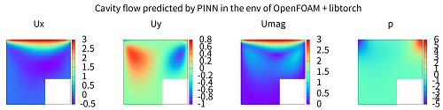

    You can use the following code to initialize libtorch tensors from OpenFOAM mesh. It is much easier to generate any kinds of geometries. Please see the following clipped cavity geometry. I am using English since I hope it can be helpful for all the people.
        // openfoam initialization
        vectorField ofMesh = mesh.C();
        auto meshTorch = torch::full({ofMesh.size(),1,2}, 0.0);
        forAll(ofMesh, i)
            double x = ofMesh[i].x();
            double y = ofMesh[i].y();
            auto posi = torch::tensor({x,y}).reshape({1,2});
            meshTorch[i] = posi;
        const surfaceVectorField& Cf = mesh.Cf();
        label topID = mesh.boundaryMesh().findPatchID("top");
        label leftID = mesh.boundaryMesh().findPatchID("left");
        label rightID = mesh.boundaryMesh().findPatchID("right");
        label bottomID = mesh.boundaryMesh().findPatchID("bottom");
        vectorField cfTop = Cf.boundaryField()[topID];
        vectorField cfLeft = Cf.boundaryField()[leftID];
        vectorField cfRight = Cf.boundaryField()[rightID];
        vectorField cfBottom = Cf.boundaryField()[bottomID];
        auto top = torch::full({cfTop.size(),1,2}, 0.0);
        auto left = torch::full({cfLeft.size(),1,2}, 0.0);
        auto right = torch::full({cfRight.size(),1,2}, 0.0);
        auto bottom = torch::full({cfBottom.size(),1,2}, 0.0);
        forAll(cfTop, i)
            double x = cfTop[i].x();
            double y = cfTop[i].y();
            top[i] = posi;
        forAll(cfRight, i)
            double x = cfRight[i].x();
            double y = cfRight[i].y();
            right[i] = posi;
        forAll(cfLeft, i)
            double x = cfLeft[i].x();
            double y = cfLeft[i].y();
            left[i] = posi;
        forAll(cfBottom, i)
            double x = cfBottom[i].x();
            double y = cfBottom[i].y();
            bottom[i] = posi;
        meshTorch = meshTorch.reshape({-1,2});
        top = top.reshape({-1,2});
        left = left.reshape({-1,2});
        right = right.reshape({-1,2});
        bottom = bottom.reshape({-1,2});
        auto u_top = torch::full({cfTop.size()}, vel);
        auto v_top = torch::full({cfTop.size()}, 0.0);
        std::cout<< "top: " << top << std::endl;
        std::cout<< "left: " << left << std::endl;
        std::cout<< "right: " << right << std::endl;
        std::cout<< "bottom: " << bottom << std::endl;

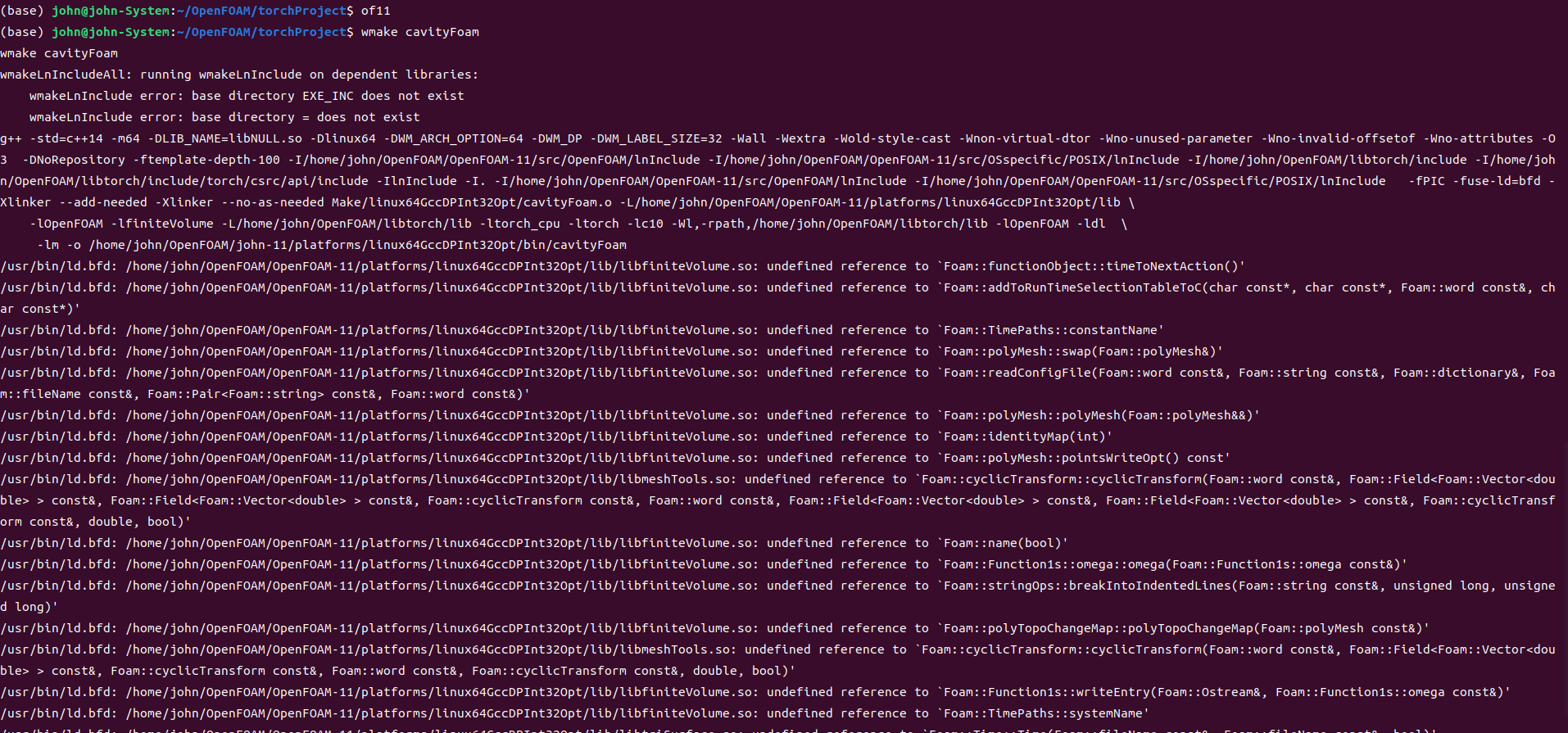

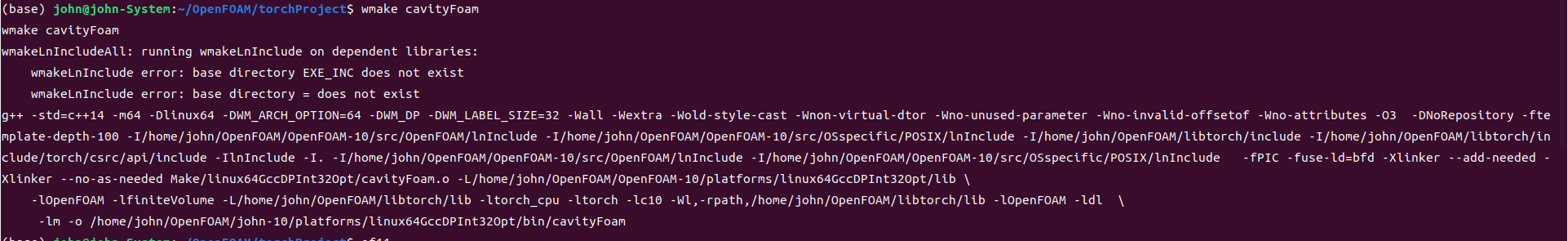

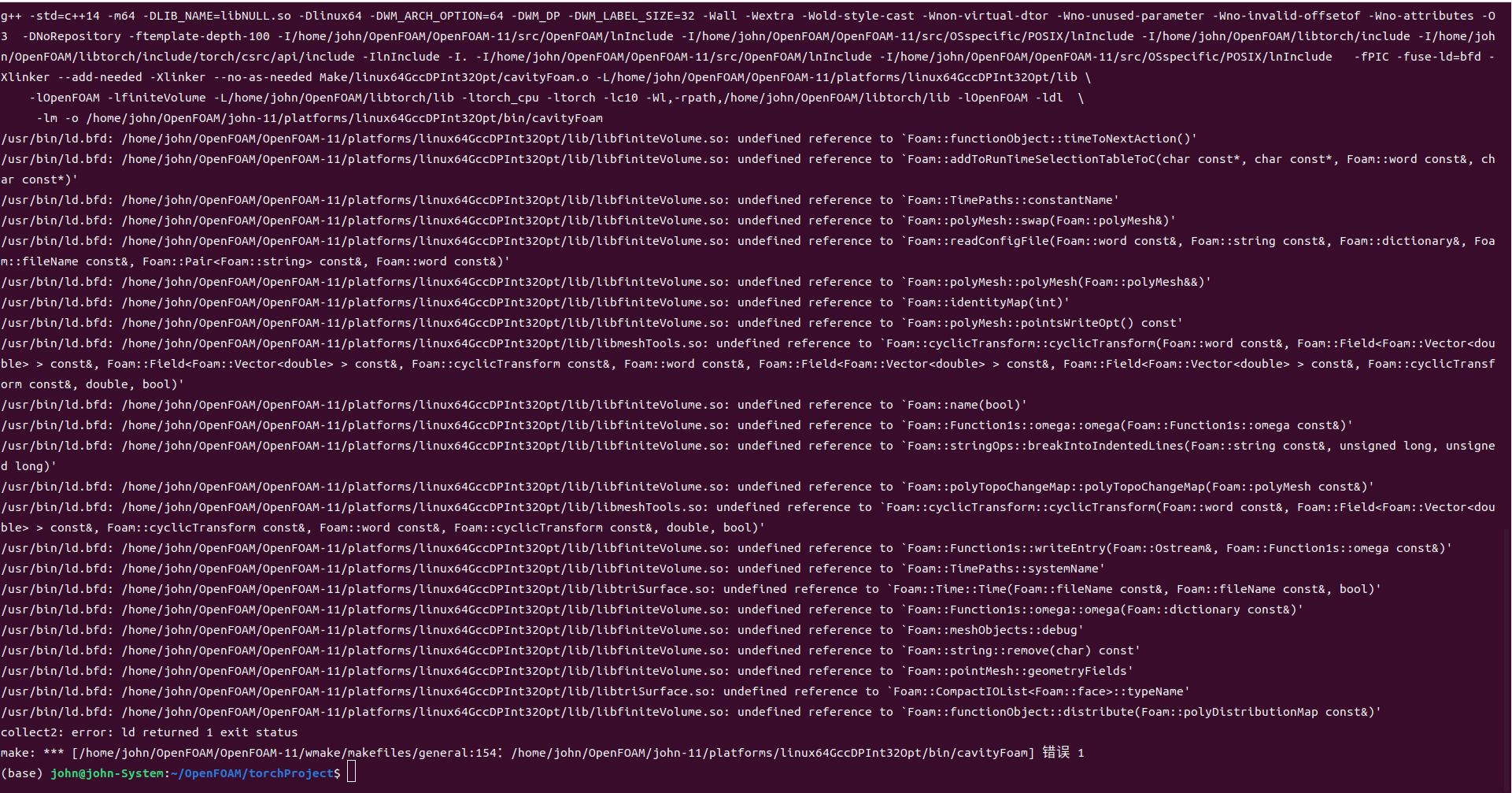

    @李东岳 李老师您好,我在看您发的那个顶盖驱动流的代码的时候有个问题,我的电脑安装了openfoam10和11,同样的文件内容为什么在of10下我可以成功编译,但在of11下不可以呢。在11下,一开始提示找不到libtriSurface.so和libsurfMesh.so,然后我在bashrc中添加了,export LD_LIBRARY_PATH=$LD_LIBRARY_PATH:/home/john/OpenFOAM/OpenFOAM-11/platforms/linux64GccDPInt32Opt/lib,随后再次运行出现了这样的问题。
    #72
    of10跟of11的Make下面的options不一样,我先用of10吧。等过段时间再debug

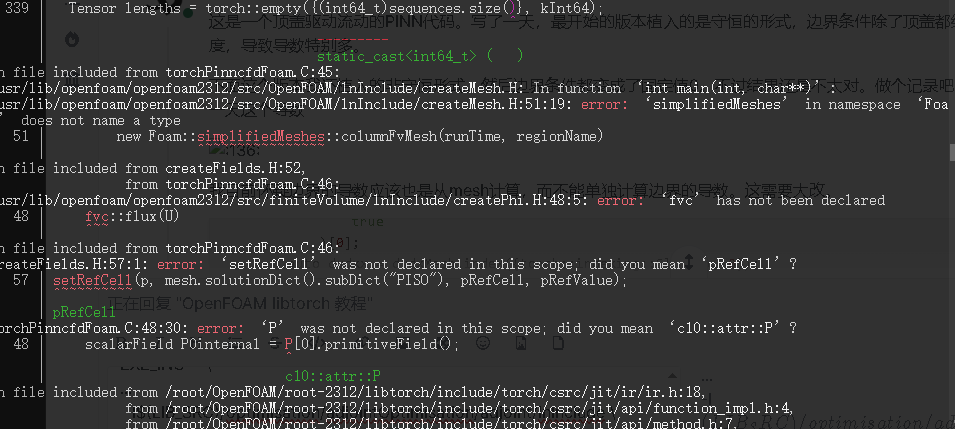

    torchFoam.C:1:10: fatal error: torch/torch.h: 没有那个文件或目录
    1 | #include <torch/torch.h>
    我是小白,请教一下,我提示这个错误是怎么回事?wmake的时候提示的,用的用的of2212
    在 中回复了 iaasoqhu 最后由 编辑
    #74
    @iaasoqhu 今天才看见,你的基础环境没有配好。
    I 1 条回复 最后回复

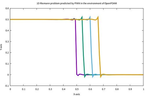

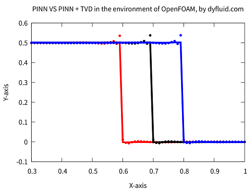

    在本帖12楼我贴出了原生PINN求解对流方程的方法,存在数值震荡。最近我开源了PINN + TVD格式的代码,请参考: http://dyfluid.com/pinn4.html
    在画图的时候,需要原生PINN预测的速度数据。在此: U-PINN-V
