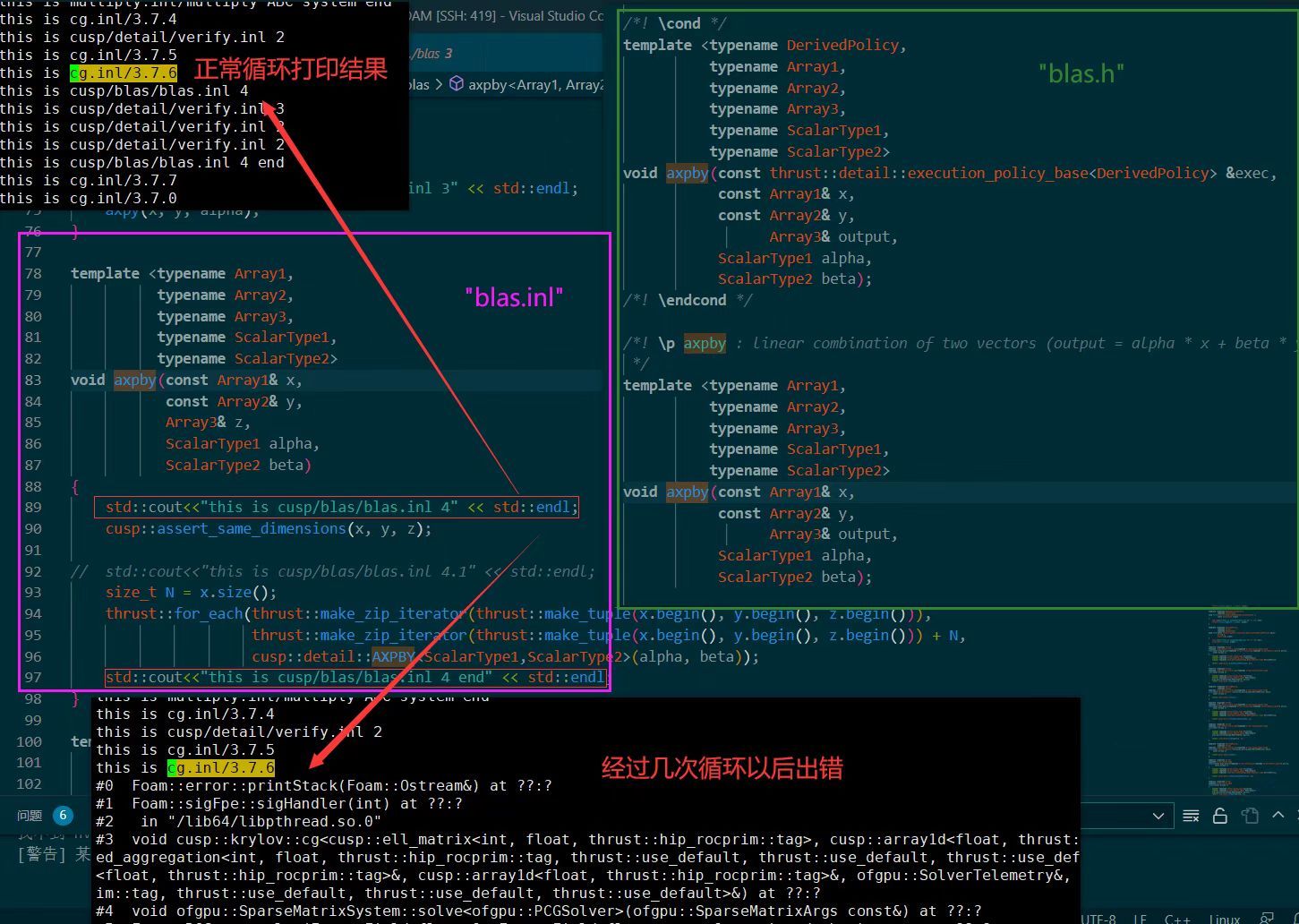

    编译成功使用smoothed_aggregation预条件后运行17个循环以后报如下错误:
    #1  Foam::sigFpe::sigHandler(int) at ??:?
    #2   in "/lib64/libpthread.so.0"
    #3  void cusp::krylov::cg<cusp::ell_matrix<int, float, thrust::hip_rocprim::tag>, cusp::array1d<float, thrust::hip_rocprim::tag>, ofgpu::SolverTelemetry, cusp::precond::aggregation::smoothed_aggregation<int, float, thrust::hip_rocprim::tag, thrust::use_default, thrust::use_default, thrust::use_default> >(cusp::ell_matrix<int, float, thrust::hip_rocprim::tag>&, cusp::array1d<float, thrust::hip_rocprim::tag>&, cusp::array1d<float, thrust::hip_rocprim::tag>&, ofgpu::SolverTelemetry&, cusp::precond::aggregation::smoothed_aggregation<int, float, thrust::hip_rocprim::tag, thrust::use_default, thrust::use_default, thrust::use_default>&) at ??:?
    #4  void ofgpu::SparseMatrixSystem::solve<ofgpu::PCGSolver>(ofgpu::SparseMatrixArgs const&) at ??:?
    #5  Foam::PCGgpu::solve(Foam::Field<float>&, Foam::Field<float> const&, unsigned char) const at ??:?
    #6  Foam::fvMatrix<float>::solveSegregated(Foam::dictionary const&) at ??:?
    #7  Foam::fvMatrix<float>::solve(Foam::dictionary const&) at ??:?
    #8  Foam::fvMatrix<float>::solve() at ??:?
     in "/public/home/xxx/OpenFOAM/OpenFOAM-2.2.x/platforms/linux64GccSPDebug/bin/simpleFoam"
    #10  __libc_start_main in "/lib64/libc.so.6"
    /opt/gridview/slurm/spool_slurmd/job5380749/slurm_script: line 22: 83076 Floating point exception~/OpenFOAM/OpenFOAM-2.2.x/platforms/linux64GccSPDebug/bin/simpleFoam
    [定位到代码中是blas文件中的函数axpby,如下图](error1.jpg .)
    axpby()函数的功能是将两个向量相加,y = αx + βy,我尝试用axpy()函数替代,结果也是在相同位置报错。axpy():y = α*x + y
