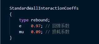

      (1)open foam是否可以模拟颗粒-颗粒以及颗粒-壁面的黏结效应,颗粒在壁面的黏结系数是哪个参数?算例文档中只有颗粒与壁面的反弹与损耗系数。

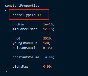

      (2)颗粒类型在哪里选择,目前至看到parcelTypeID 1,有其他形状的颗粒类型吗

        can@x260-TC ~/.local/share/OpenFOAM/OpenFOAM-8 %grep -R 'parcelTypeId' ./                                                                                                                          (git)-[master]-
        ./tutorials/lagrangian/particleFoam/mixerVesselAMI2D/constant/kinematicCloudProperties:    parcelTypeId 1;
        ./tutorials/lagrangian/DPMFoam/Goldschmidt/constant/kinematicCloudProperties:    parcelTypeId 1;
        ./tutorials/lagrangian/coalChemistryFoam/simplifiedSiwek/constant/limestoneCloud1Properties:    parcelTypeId    2;
