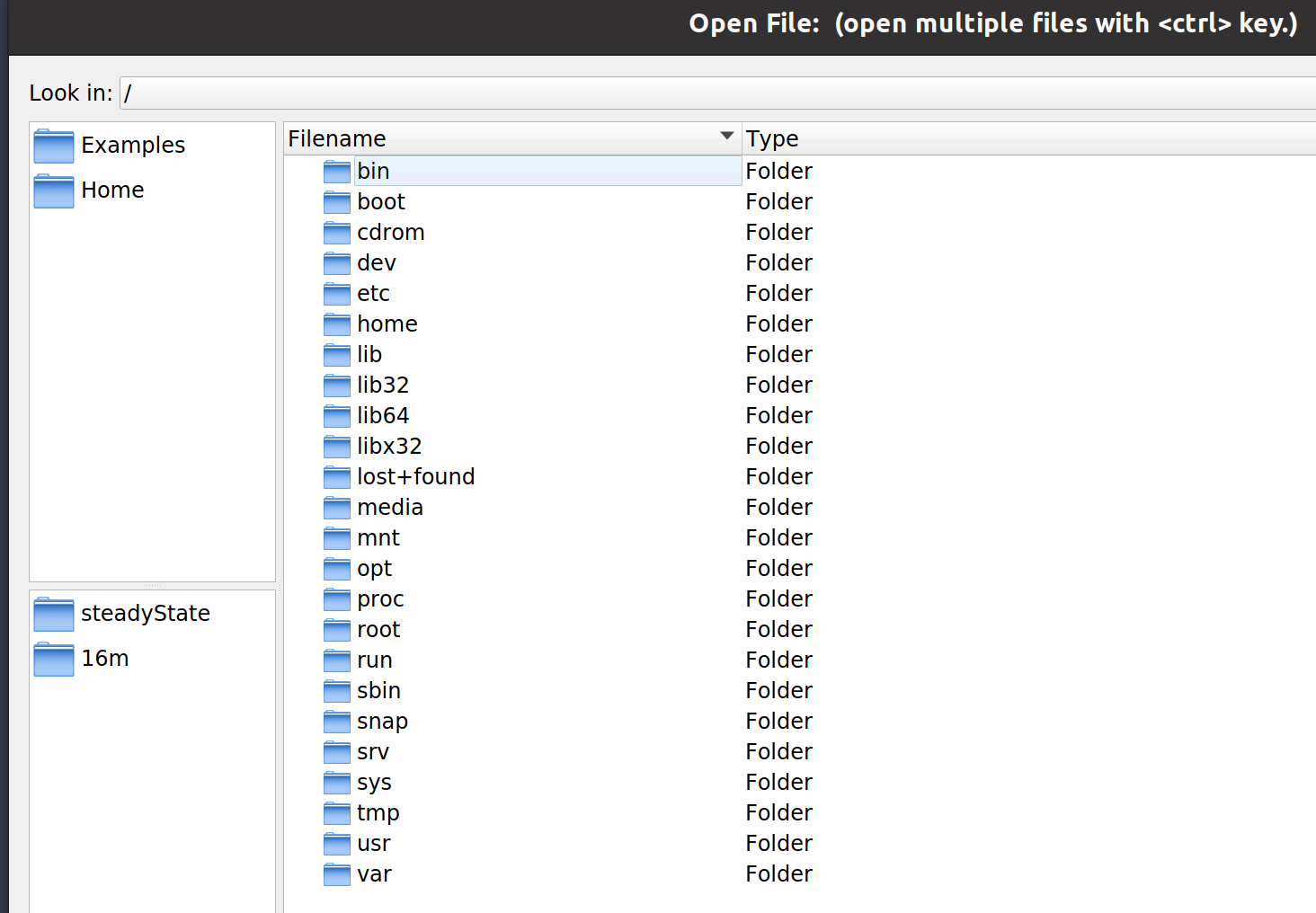

    Sorry my Chinese input is missing. Actually you can open your hard drive in /media folder, as you can see in the following image. Its still not necessary to compile it.

    @李东岳 在 关于绿色版paraview 中说:
    :136: :136: :136: 感谢前辈
