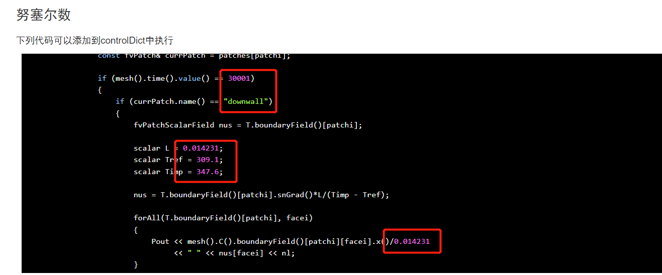

    李老师您好,请问输出努塞尔数代码是直接放进去吗?还是里边的部分数据需要进行修改呢微信截图_20221112113853.png ?
    在 中回复了 2019201300 最后由 编辑
    #34
    @2019201300 这个我太久之前写的。已经忘了。但是这个代码只是提供案例。具体数值大概率需要自己改一下。直接放在controlDict下面。

    @疏影横斜水清浅 参考下下边这个代码吧。
    coded
         libs ( "libutilityFunctionObjects.so" );
         enabled         true;
         type            coded;
         name           printMinU;
         executeControl  timeStep;
         executeInterval 200;
         writeControl   timeStep;
         writeInterval  200;
         codeOptions
             -I$(LIB_SRC)/meshTools/lnInclude
         codeExecute
             const volScalarField& T
                 mesh().lookupObject<volScalarField>("T")
             const fvPatchList& patches = mesh().boundary();
                 std::ofstream file;
                 file.open ("nus", std::ofstream::out | std::ofstream::app);
             forAll(patches, patchi)
                 const fvPatch& currPatch = patches[patchi];
                     if (currPatch.name() == "bottomWall")
                         fvPatchScalarField nus = T.boundaryField()[patchi];
                         scalar L = 0.1;
                         scalar Timp = 343;
                         const volScalarField& T = mesh().lookupObject<volScalarField>("T");
                         scalarField Tinternal = T.internalField();
                         scalar sumT = gSum(Tinternal * mesh().V());
                         scalar V = gSum(mesh().V());
                         scalar avgT = sumT / V;
                         nus = T.boundaryField()[patchi].snGrad()*L/(Timp - avgT);
                         //nus2file << "Time: " << mesh().time().timeName() << " " << nus << nl;
                         forAll(T.boundaryField()[patchi], facei)
                             //Pout << mesh().C().boundaryField()[patchi][facei].x()/0.1
                               //   << " " << nus[facei] << nl;
                             file << "Time: " << mesh().time().timeName() << " " << mesh().C().boundaryField()[patchi][facei].x() << " " << mesh().C().boundaryField()[patchi][facei].z() << " " << nus[facei] << std::endl;
             file.close();
