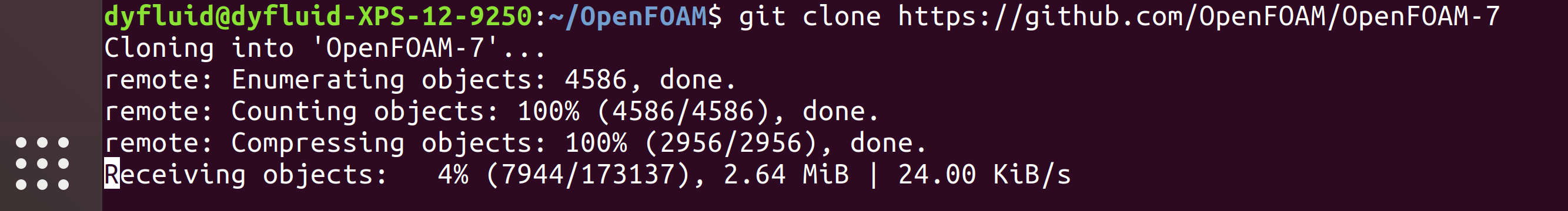

    本人新手,看到东岳老师的“东岳流体”上有安装教程,到了下载openfoam.tar和Thirdparty.tar文件那一步,但是好像Github上下东西太慢了,而且还下载失败,不知道大家有没有人已经下下来了,哪个好人给个百度云或者什么的,实在是下不动啊。先谢谢大家了,这也是注册CFD中文网第一次发帖。

    @海de彼岸 不应该啊,github我这面一般都是几兆每秒呢。之前考虑放过,但是琢磨还是原生的比较有滋味 :ok:

    I just tried, yep its slow... 24k/s Please wait a moment, I will download it and push it to a domestic server. I will let you know then.

    https://git.dev.tencent.com/dyfluid/OpenFOAM-7.git
    try:
    git clone https://git.dev.tencent.com/dyfluid/OpenFOAM-7.git
    should be very fast

    @东岳 谢谢,已经安装成功,非常感谢!
