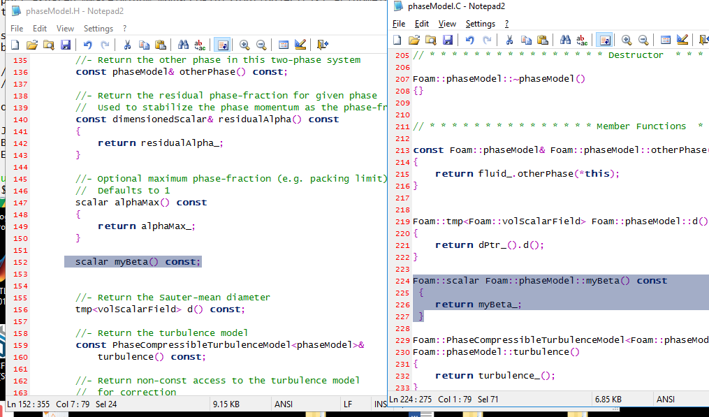

    @bestucan But why alphaMax() was originally defined in the phaseModel.H without any error?
            scalar alphaMax() const
                return alphaMax_;
    After I defined only scalar myBeta() in phaseModel.H, the following error occurs:
    In file included from phaseModel/phaseModel.C:26:0:
    phaseModel/phaseModel.H:158:29: error: invalid declarator before 'd'
             tmp<volScalarField> d() const;
    phaseModel/phaseModel.H:162:26: error: non-member function 'const Foam::PhaseCompressibleTurbulenceModel<Foam::phaseModel>& Foam::turbulence()' cannot have cv-qualifier
                 turbulence() const;
  • New scalar in phaseModel.c
    K kimy
    @bestucan Many Thanks. I have a confusion that you defined the following two scalar and function in phaseModel.H
    <         scalar myBeta_;
    195,196d193
    <         scalar myBeta() const;
    While in original file, according to the definition of alphaMax
                return myBeta_;
    and you put this code in phaseModel.C ?
