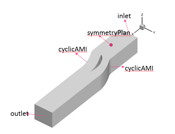

    @cfd-china 好的,我这么设置周期边界没有问题吧,两个面的距离是22mm
    |  \\    /   O peration     | Version:  3.0.1                                 |
    |   \\  /    A nd           | Web:      www.OpenFOAM.org                      |
    FoamFile
        version     2.0;
        format      ascii;
        class       polyBoundaryMesh;
        location    "constant/polyMesh";
        object      boundary;
    8
        hub
            type wall;
            nFaces          30748;
            startFace       5380555;
        inlet
            type patch;
            nFaces          5546;
            startFace       5411303;
        outlet
            type patch;
            nFaces          4543;
            startFace       5416849;
        per1
              type            cyclicAMI;
            nFaces          15340;
            startFace       5421392;
            neighbourPatch   per2;
            matchTolerance    0.01;
    	transform         translational;
    	separationVector (0 0.022 0);
        per2
             type            cyclicAMI;
           nFaces          15340;
           startFace       5436732;
           neighbourPatch   per1;
           separationVector (0 -0.022 0);
        ps
            type            wall;
            nFaces          10266;
            startFace       5452072;
        ss
            type            wall;
            nFaces          11151;
            startFace       5462338;
        sym
            type symmetryPlane;
            nFaces          30748;
            startFace       5473489;

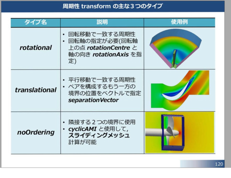

    @cfd-china 我感觉这个我理解的可能有问题,是应该给平移距离的大小(0.022m),还是(0,1,0)这么给。当时从这里看见的0_1490441899214_cyclic.jpg
