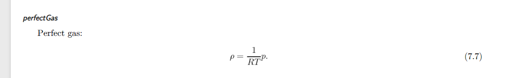

    实际情况下,气体的密度应该是\rho=PM/RT,需要考虑物质的摩尔质量,但是为什么openfoam中在计算密度时,摩尔质量被忽略了。
    想请问一下,openfoam是已经将物质的量放到气体常数里面去了吗?14d09af9-06e4-4eba-bd51-4eae84400da9-8750bdcf976665629967416c98ac2691_.png 3732823c-9614-4930-8b9f-6faa996690bf-dd59659fb9de3c1dc3760328be9f1776_.png

    @脉动通风 是的。
    $$\rho = \frac {1} {RT} p= \psi p$$
    $$ \psi = \frac {1} {RT}=\frac {1} {\frac{RR}{M} T}$$
    在perfectGasI.H文件中可以看到:
    $$ \psi = \frac {1} {RT}$$
     template<class Specie>
     inline Foam::scalar Foam::perfectGas<Specie>::psi(scalar p, scalar T) const
         return 1.0/(this->R()*T);
    this->R()可以在speciesI.H文件里看到:(从这里可以看出来RR除以摩尔质量)
    $$ R = \frac{RR}{M} $$
     inline scalar specie::R() const
         return RR/molWeight_;
    这个RR在thermodynamicConstants.C文件中:
         // Note: the 1e3 converts from /mol to /kmol for consistency with the
         // SI choice of kg rather than g for mass.
         // This is not appropriate for USCS and will be changed to an entry in
         // the DimensionedConstants dictionary in etc/controlDict
         const scalar RR = 1e3*physicoChemical::R.value();
    physicoChemical::R.value()就是通用气体常数8.314。因为molWeight单位是kg/kmol,RR要乘以1000.

    @wangfei9088 非常感谢大佬的指点!! 完美解决了这个问题:140:
