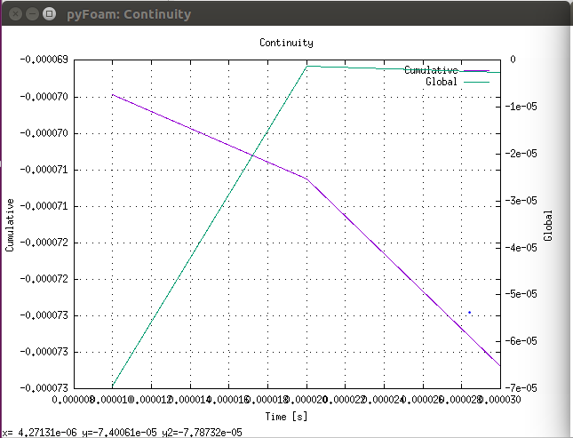

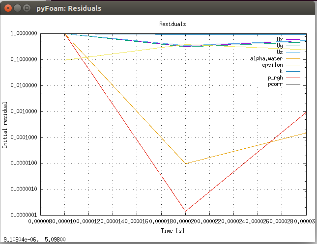

    各位老师同学好。本人最近在用InterPhaseChangeDyMFoam计算旋转机械(介质是水)的空化问题,边界条件是入口速度fixedValue ,压力totalpressure;出口速度inletOutlet,压力fixedFluxPressure,湍流采用标准K-e模型,额定的转速是303rad/s,入口段直径0.125m,速度给定5m/s,给定的k和epsilon初值分别是0.0284和0.09,时间步长设定1e-5,网格40W左右(非结构),用AMI连接域。在计算几步后就回出现崩溃,但是通过大幅度缩小时间步长和减少转速(大概到50rad)可以正常收敛,但是这两者都不太能接受。所以想寻求各位大神帮忙看看有没有更好的方法能稳定计算,或者如果是我的设置有问题也欢迎指正~~~~附上log和pyfoam的图

    GAMG:  Solving for pcorr, Initial residual = 1, Final residual = 0.0046122, No Iterations 7
    time step continuity errors : sum local = 7.2582e-05, global = -6.94718e-05, cumulative = -6.94718e-05

    time step continuity errors : sum local = 0.000188015, global = -1.15051e-06, cumulative = -7.06224e-05

    Courant Number mean: 0.0203512 max: 31.9041

    time step continuity errors : sum local = 0.000687359, global = -2.57908e-06, cumulative = -7.32014e-05

    Liquid phase volume fraction = 0.985415  Min(alpha.water) = -0.0498938  Max(alpha.water) = 1.00005
    smoothSolver:  Solving for Ux, Initial residual = 0.556211, Final residual = 0.0456756, No Iterations 1
    smoothSolver:  Solving for Uy, Initial residual = 0.483701, Final residual = 0.0456852, No Iterations 1
    smoothSolver:  Solving for Uz, Initial residual = 0.54432, Final residual = 0.0380588, No Iterations 1
    GAMG:  Solving for p_rgh, Initial residual = 0.000953864, Final residual = 3.46933e-10, No Iterations 7
