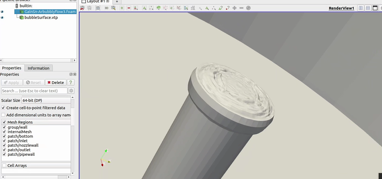

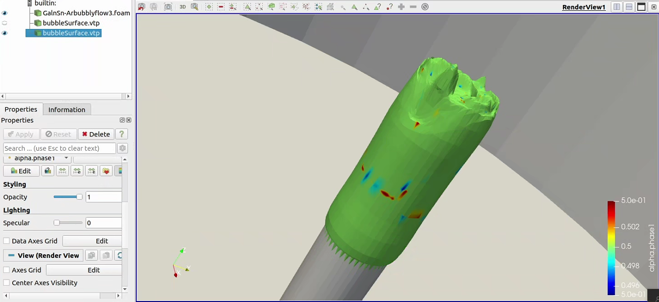

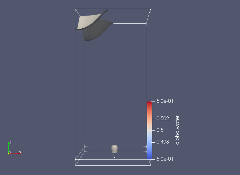

 openfoam使用VOF模拟孔口气泡吹入 如图所示,下部孔口气泡吹入时,上方的自由液面部分会出现如图所示的对称的凹陷,这是什么原因造成的,应该调整p_rgh字典文件(设定的自由液面处是totalpressure)还是要调整离散文件。 如图所示,下部孔口气泡吹入时,上方的自由液面部分会出现如图所示的对称的凹陷,这是什么原因造成的,应该调整p_rgh字典文件(设定的自由液面处是totalpressure)还是要调整离散文件。

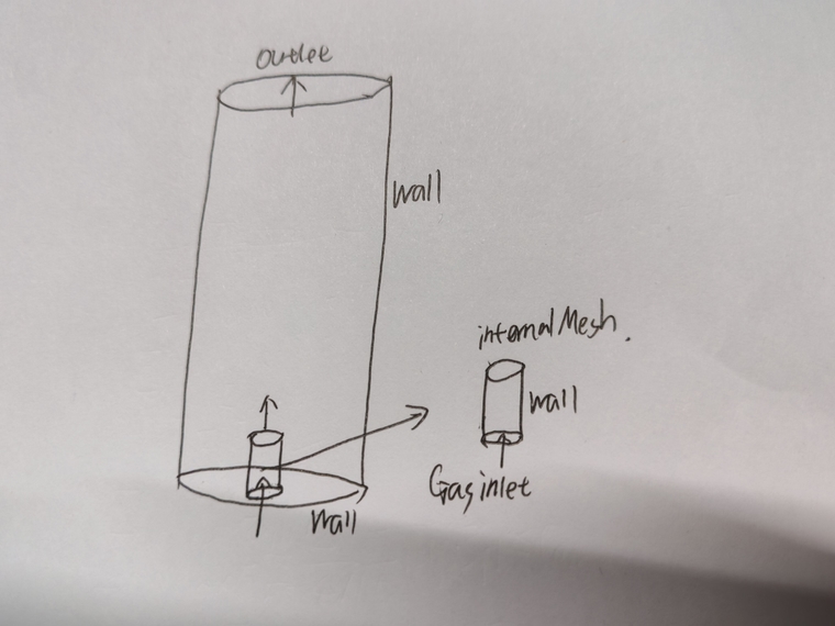

 openfoam中如何将一个面设置为内部面@李东岳 李老师您的意思是我只画小圆柱的两个面就行是么
 openfoam中如何将一个面设置为内部面针对这种计算域,想要在openfoam中将喷嘴的下部面进气,而上部面应该设置为内部面才能使流体顺利通过,已经绘制了pipetop.stl几何文件,想要利用snappyhexmesh加密喷嘴处的网格,openfoam中有没有能够将toposet捕捉到的这个面转化为一个内部面的工具,或者其他工具能够使喷嘴通气,请各位大佬赐教。

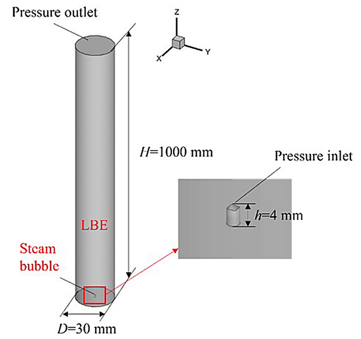

 interIsofoam射流问题模拟的具体工况如图所示
 圆柱容器里面是液体,圆柱喷嘴喷出气体(喷嘴上部面转化为内部网格处理),使用interIsofoam求解器,主要想观察气体喷出后生成的气泡的形状和运动轨迹,网格由icem绘制转化至openfoam,checkmesh信息如下:Check mesh... Time = 0 Mesh stats points: 624312 faces: 1851102 internal faces: 1828728 cells: 613305 faces per cell: 6 boundary patches: 5 point zones: 0 face zones: 3 cell zones: 2 Overall number of cells of each type: hexahedra: 613305 prisms: 0 wedges: 0 pyramids: 0 tet wedges: 0 tetrahedra: 0 polyhedra: 0 Checking topology... Boundary definition OK. Cell to face addressing OK. Point usage OK. Upper triangular ordering OK. Face vertices OK. Number of regions: 1 (OK). Checking patch topology for multiply connected surfaces... Patch Faces Points Surface topology outlet 1485 1508 ok (non-closed singly connected) nozzlewall 1232 660 multiply connected (shared edge) bottom 616 660 ok (non-closed singly connected) pipewall 18172 18216 ok (non-closed singly connected) inlet 869 892 ok (non-closed singly connected) ".*" 22374 21760 multiply connected (shared edge) Detected 1232 bad edges (possibly relevant for finite-area) Checking faceZone topology for multiply connected surfaces... FaceZone Faces Points Surface topology int_FLUID 1792538 612440 multiply connected (shared edge) int_FLUID_AIR 35321 13380 multiply connected (shared edge) int_INTERIOR1 869 892 ok (non-closed singly connected) <<Writing 624224 conflicting points to set nonManifoldPoints Checking basic cellZone addressing... CellZone Cells Points Volume BoundingBox FLUID 601139 612440 0.000704116 (-0.0149602 -0.0149572 0) (0.0149602 0.0149572 1) FLUID_AIR 12166 13380 1.92837e-09 (-0.000391458 -0.000391429 0) (0.000391458 0.000391429 0.004) Checking basic pointZone addressing... No pointZones found. Checking geometry... Overall domain bounding box (-0.0149602 -0.0149572 0) (0.0149602 0.0149572 1) Mesh has 3 geometric (non-empty/wedge) directions (1 1 1) Mesh has 3 solution (non-empty) directions (1 1 1) Boundary openness (4.6938e-16 1.39741e-15 1.52826e-18) OK. Max cell openness = 4.03117e-16 OK. Max aspect ratio = 389.103 OK. Minimum face area = 2.38205e-10. Maximum face area = 7.65441e-06. Face area magnitudes OK. Min volume = 5.02898e-14. Max volume = 1.47182e-08. Total volume = 0.000704118. Cell volumes OK. Mesh non-orthogonality Max: 35.2075 average: 4.51619 Non-orthogonality check OK. Face pyramids OK. Max skewness = 1.90366 OK. Coupled point location match (average 0) OK. Mesh OK.现在存在的问题是虽然网格数只有60w,但计算开始时的时间步长在10e-5,随着计算过程的推进逐渐变小至10e-30,并且喷嘴上方喷出的气体应该转变为气泡分类而不是如下图所示的一个柱状区域,我想求助各位大佬,我这个是网格的问题还是算法的问题。
