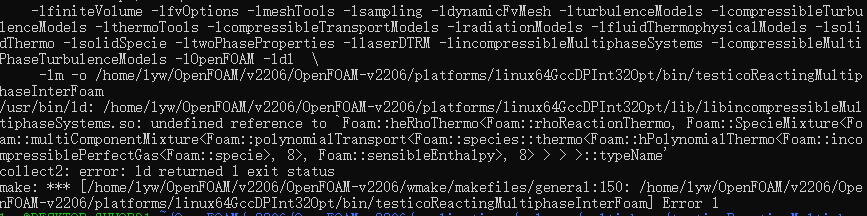

    -lfiniteVolume -lfvOptions -lmeshTools -lsampling -ldynamicFvMesh -lturbulenceModels -lcompressibleTurbulenceModels -lthermoTools -lcompressibleTransportModels -lradiationModels -lfluidThermophysicalModels -lsolidThermo -lsolidSpecie -ltwoPhaseProperties -llaserDTRM -lincompressibleMultiphaseSystems -lcompressibleMultiPhaseTurbulenceModels -lOpenFOAM -ldl
    -lm -o /home/lyw/OpenFOAM/v2206/OpenFOAM-v2206/platforms/linux64GccDPInt32Opt/bin/testicoReactingMultiphaseInterFoam
    /usr/bin/ld: /home/lyw/OpenFOAM/v2206/OpenFOAM-v2206/platforms/linux64GccDPInt32Opt/lib/libincompressibleMultiphaseSystems.so: undefined reference to `Foam::heRhoThermo<Foam::rhoReactionThermo, Foam::SpecieMixture<Foam::multiComponentMixture<Foam::polynomialTransport<Foam::species::thermo<Foam::hPolynomialThermo<Foam::incompressiblePerfectGasFoam::specie, 8>, Foam::sensibleEnthalpy>, 8> > > >::typeName'
    collect2: error: ld returned 1 exit status
    make: *** [/home/lyw/OpenFOAM/v2206/OpenFOAM-v2206/wmake/makefiles/general:150: /home/lyw/OpenFOAM/v2206/OpenFOAM-v2206/platforms/linux64GccDPInt32Opt/bin/testicoReactingMultiphaseInterFoam] Error 1

    请问,怎么才能将报错的组合编译成功?是哪里错了吗?没提到的地方基本都没有改动
