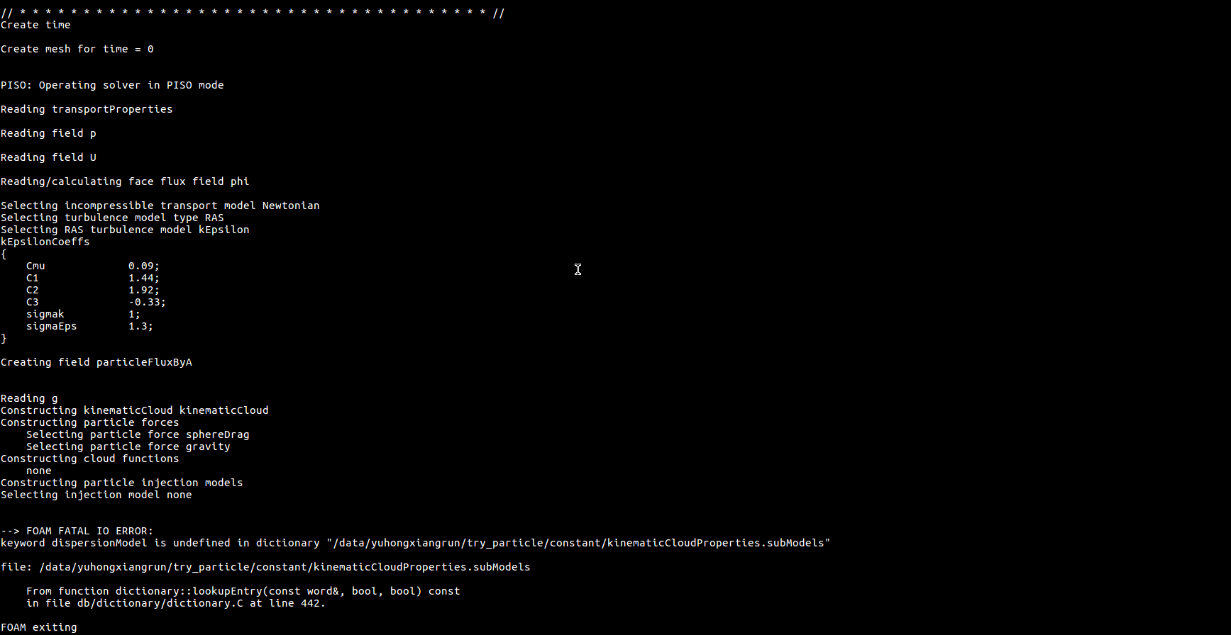

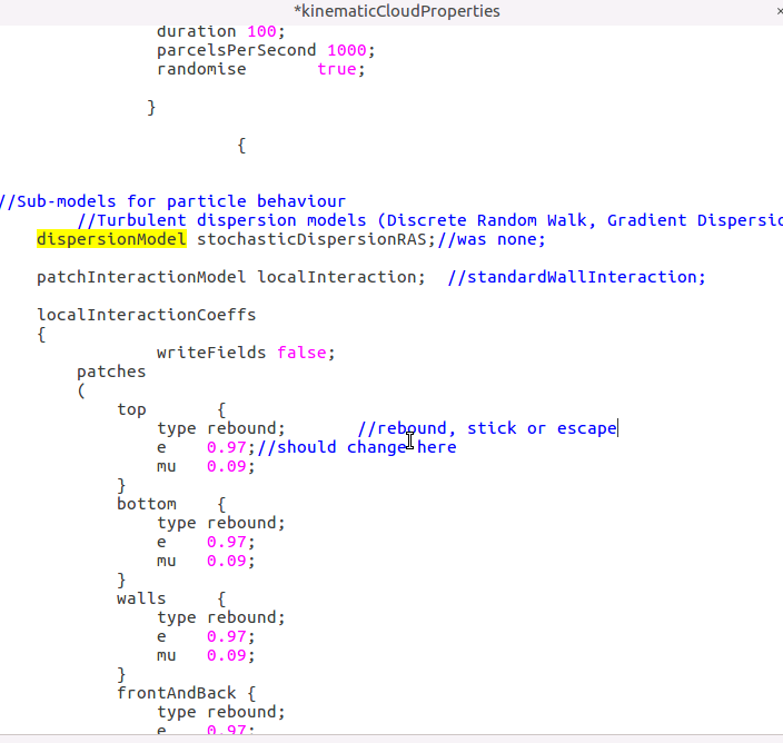

    0_1539246667618_9c833513-0458-4f8a-903d-072b01a4c391-image.png 如图所示,问题是在文件中已经定义过了dispersionModel, see following picture0_1539246741888_35679c20-690a-4b37-bc1f-8374a1190586-image.png
    你前面多了个{,去掉看看
    yuhx
    解决了,我太粗心了,谢谢老师!!!!
